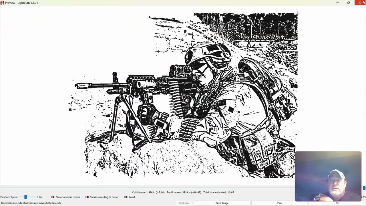

Used the LightBurn Image Trace on the first two photos posted. Below I show the first attempt and the results. With a better source image, I am sure I could get even better results for this type of art using the provided tools within LightBurn. ![]()
Here is an example of similar art where I leveraged the LightBurn Image Trace previously, with a little better source image.
(click to enlarge)
interesting, what is your imaging source, do you mean you vectored it or put it in another format or adjusted the image ie made it larger then traced it?. What you have done looks great.
I simply copied the image you posted above (Ctrl + C / β + C mac) and pasted onto the workspace (Ctrl + V β + V mac), then with your image selected, did an Image Trace, adjusted to get what I liked and hit OK to commit. Your image has now been vectorized, using the tools provided within LightBurn. No image adjustment nor external software used to produce this vector version of you originally posted image. ![]()

You offer me too much credit here friend. I am sure my experience does have some effect, but to be candid, I looked at what was provided and compared to the results I was getting. I tried to capture as much of the detail as I could see when using the trace image tool, clicking the βFadeβ button helps with this. Just eye-ballin it. ![]()
