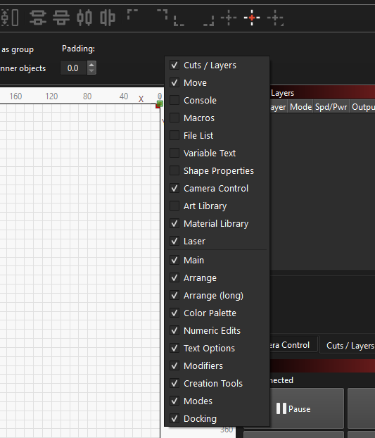

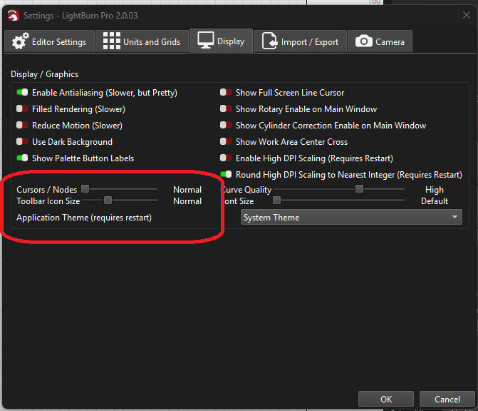

If you go to ‘Edit > Settings’ in LightBurn and go over to the ‘Display’ tab, you can reduce the size of the font, cursors/nodes, and toolbar icon size (requires a restart to take effect)
You can also right click in the sidebars/menu bar areas and disable icon sets you don’t use to save space (or use the ‘Window’ menu in the top bar)

Had to do above just to get it to work, and you not build for smaller screens the older version worked fine… Maybe a skin option or something… Problem seems to be the Material Lib Dialog and the popups is calls for editing cuts etc.
