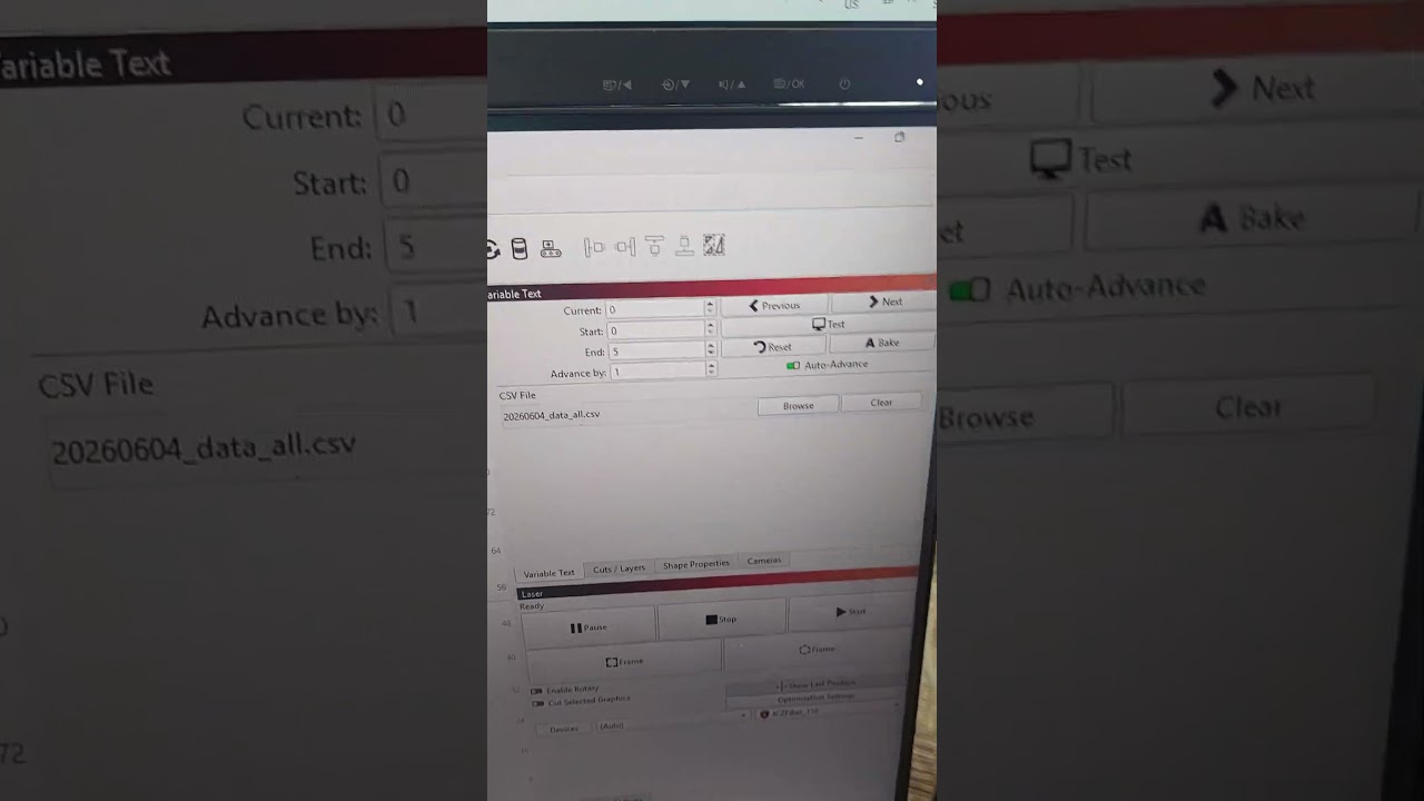

Version 2.1.02 hangs variable text jobs after 3-5 impressions
Just upgraded to v 2.1.02
Tried variable text marking on UV laser.
It marks anywhere from 3-5 jobs in the csv file and then just hangs.

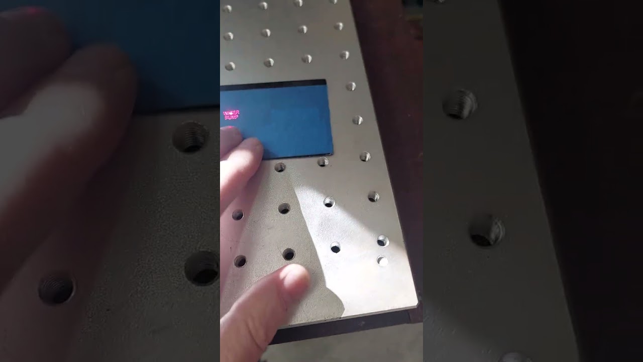

here a couple of videos showing the problem
sorry for the low quality but don’t have time for tripods and such, but it should show you what is happening

Since you all say that you’re experiencing the same issue, can you send us a screenshot of what you see when it freezes?
What I see in the first video is probably this:
The default ā€œEndā€ value in the Variable Text window is 999.
If you load a .CSV file with say, 5 lines, this End value adjusts down to the maximum available value, which is 4, because it starts counting at 0. (Computers…)
If you then load a .CVS file with more than 5 lines, LightBurn will not increase the End value on its own.
It’s debatable whether we want the End value to automatically jump to the highest value of available lines.
Let’s ask @LightBurn. What might be causing the freeze in the second video?
