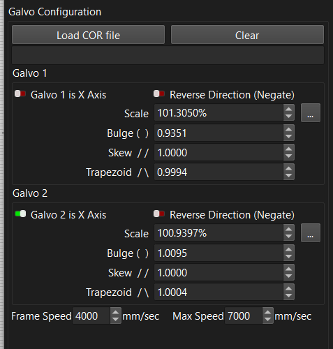

It may only be me and my user error, but I am writing to report a technical issue encountered with Lightburn version 2.1 when used in conjunction with the ComMarker Omni X 6W laser galvo.
During my setup, I utilized the 9-point calibration option, but the orientation failed to register correctly. It appears that all objects are being rotated 90 degrees to the right on the X-axis. Specifically, elements that are positioned at the top of the workspace appear on the right side of the laser bed. I attempted to engage the “Reverse Direction” on both the Y and X axes individually and together. The orientation changed, but not correctly.
To troubleshoot this, I removed Version 2.1 and reinstalled Version 2.05, which immediately restored the correct orientation. Consequently, it seems that I am currently unable to use Version 2.1 due to this calibration discrepancy.
The Omni X motherboard/controller board was replaced several months ago through ComMarker support. Following the replacement, the machine functioned correctly in LightBurn 2.05, including proper orientation and calibration behavior.
The orientation issue only appeared after upgrading to LightBurn 2.1 and was resolved immediately upon reverting back to 2.05.
I wanted to provide this information in case there may be compatibility differences involving newer controller revisions or firmware.
I did not attempt to reinstall Version 2.1 because I have jobs that need to be completed and did not want to take the time to set it all back up.
I would appreciate any guidance or patches you might have regarding this matter.
