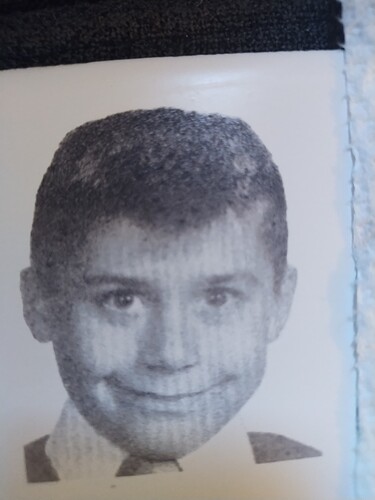

I have placed an image on a white tile and I am happy with the result except for one thing. The picture has a verticle on the whole thing. I am on an Omtech 60 machine. Here is the picture and the settings.
Screenshot 2024-09-15 175853
I did not have the streaks when I engraved this photo on wood. What’s my problem? Thanks
What is your spot size? You may be seeing repeating artifacts from overlapping passes.
Increase your line interval slightly
Thanks for jumping in James. Sorry, but I don’t know the dot size. If the issue is the interval, would not the lines be horizontal and not verticle? I’ll change the interval tomorrow and see what happens. I’ll probably to to 256 interval.
Oh, hehehe. Embarrassing mistake. Yeah, I would expect horizontal lines for my diagnosis.
Does the source photo have striations? Can you bump the sliders under the Adjust Image menu?
Can you run another test with the tile turned 90 degrees? It may be due to the tile rather than the image.
Or possibly how the coating was applied. I have a lot of problems applying an even coating.
Did you wash the tile before coating?
By the way, that is a pretty good tile image, if the ripples are ignored.
I think it is a coating issue too. I ran it again and did not have the streaks but I used the same settings and got a result not as good as the one with the streaks. I’ll keep trying. Thank you all for your input.
