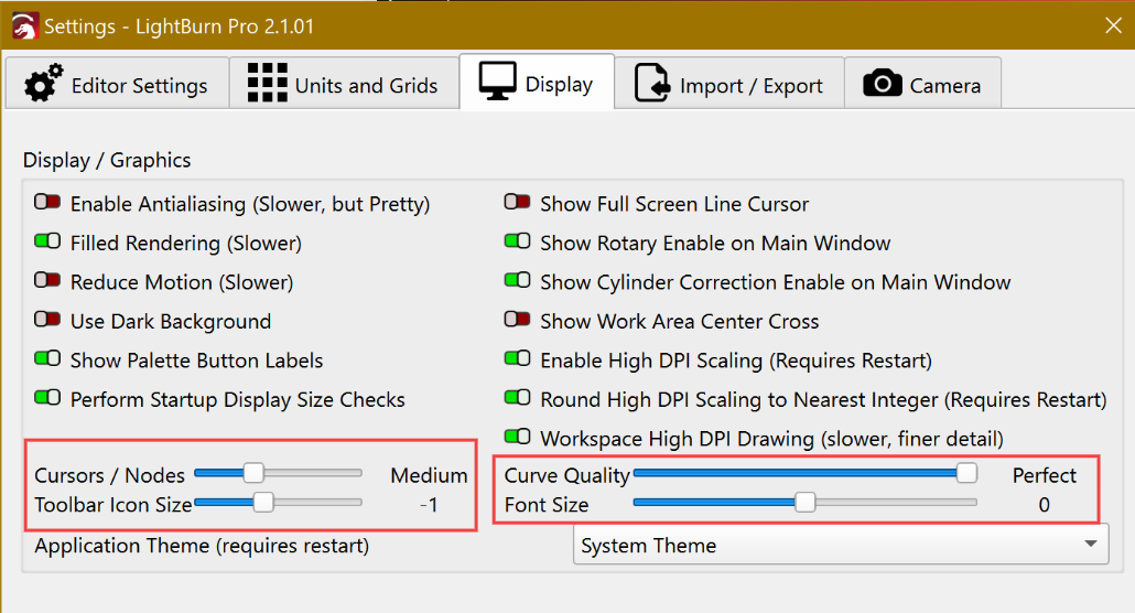

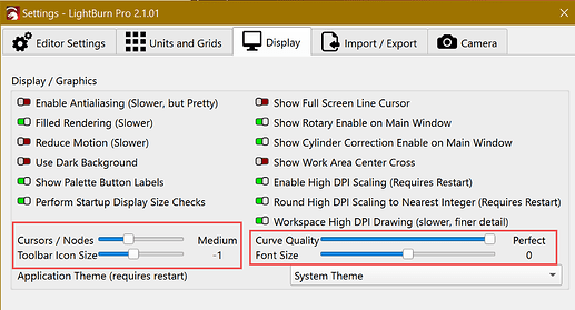

Very small icons
the layers icons at the bottom and the icons on the left are very small and unreadable. What is the fix?
A few options here:

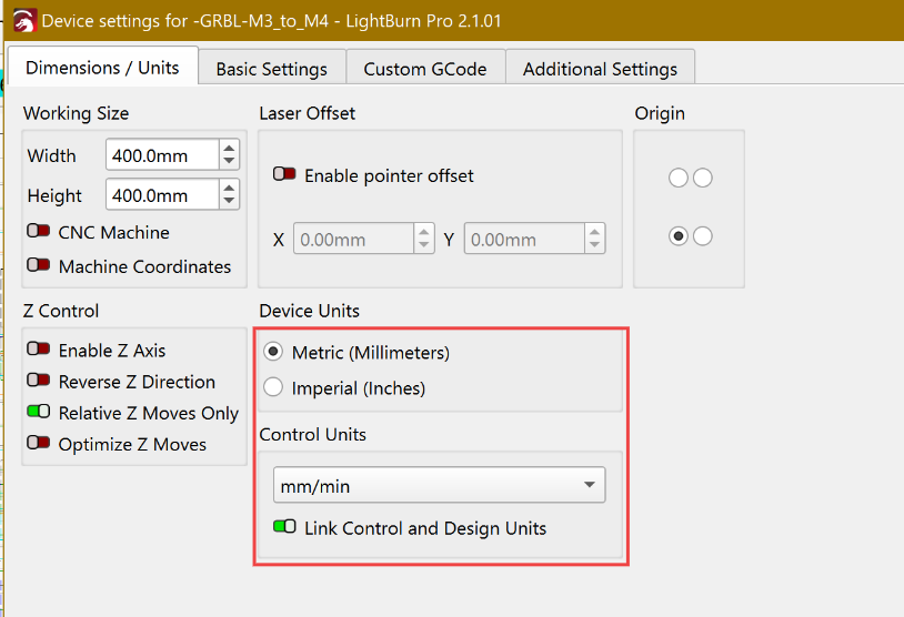

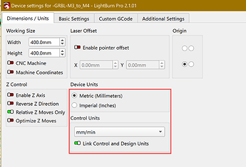

Thanks, got that fixed. But totally lost on why my laser is not cutting, It’s not the laser because I checked that in other software. I pushed the S to 50,000 and sort of cut. but I never had to do that before. Did 2.1.01 write over a bunch of the machine settings?
Check if the Units are as they were before:
