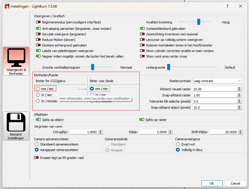

My problem is for some reason I can’t get the laser to go full blast. It’s so bad that it won’t even leaf a mark. Using lasergrbl no issue, a room full of smoke. So I tried looking it up on YouTube and here could only find to type $$ and look at $$30 that’s all up to 1000 and in device settings too. What am I doing wrong, any tips???

Make sure your lightburn is running in mm/min and not mm/sec
Edit > settings
And maybe post a image of your settings so we can take a look?
You were wright. Wow, 1 answer 1 Problem solved. Thank you very much.

For the people how maybe can’t find where to change.
Green good setting, Red wrong one for diode.
Here is a guide that will explain which options you should choose overall:
https://diode-laser-wiki.com/documentation/setting-up-the-software/
