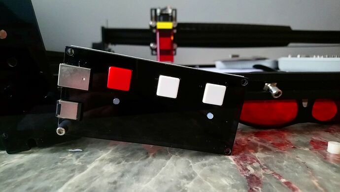

With the VigoTec VG-L7X controller you have to press and hold the power button while pressong the third button (on the right side) just shortly. Holding the power button should pull the appropriate pin to a state where the controller accepts the flashing of a firmware.
I tried it that way - my controller seems laugh at me and does nothing in terms of flashing a firmware.

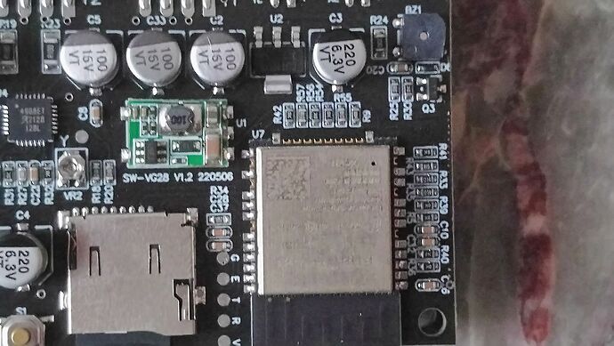

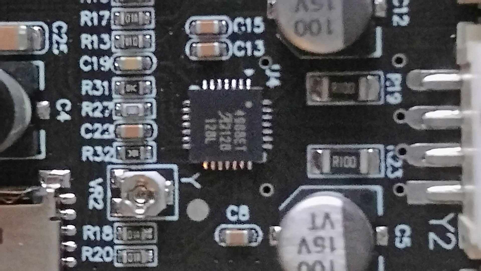

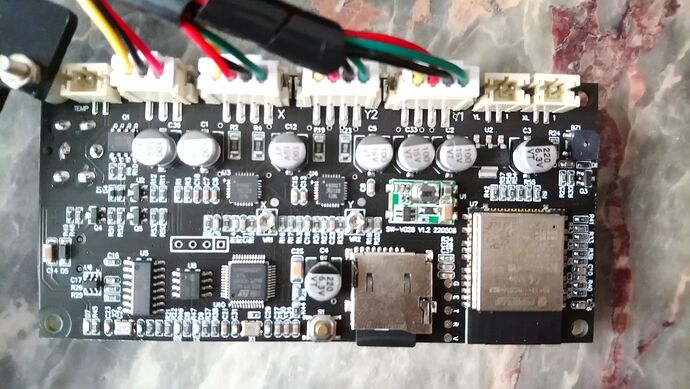

Are you able to take some high quality photos of the controller board?
I’m sorry, my mobile is a bit outdated concerning the camera.
Do you think these photos provide enough information?
Maybe it’s possible to recognize the four solder points for the two cables of the hardware hack (which might solve the problem)?
Afaik the hack seems to bypass the encryption and sends incoming g-code from the usb port directly to the controller chip (which in my case is an STM32, I think).
From what I can tell the hack basically bypasses the ESP32 entirely. So the USB connection goes from WCH340 directly to Atmega328p. So basically USB->Serial->Atmega.
I’m reviewing the datasheet for “STM32G030C8”. Hopefully I’ve read the chip model correctly.
Looks like the STM32 offers 2 different USART interfaces. USART1 provides more capabilities than USART2 but not sure otherwise how they’re different.
TX/RX pins are PA9/PA10 (USART1) or PA2/PA3 (USART2) respectively.
STM32G030C8 - Mainstream Value-Line Arm Cortex-M0+ MCU with 64 Kbytes of Flash memory, 8 Kbytes RAM, 64 MHz CPU, 2x USART, timers, ADC, comm. I/F, 2-3.6V - STMicroelectronics
The problem is solved - twice indeed. I bought a DLC32 controller board with appropriate drivers (TMC 2208) which work smart with Lightburn (I had to switch two cables from the laser connector).
And (!) the manufacturer did send me another controller board which looks the same as my original controller (the one that came with the machine). This new controller also seems to do the job as well.
