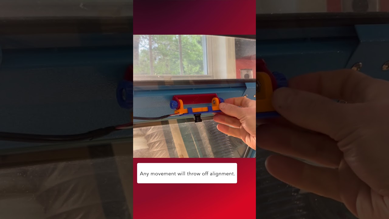

This week’s Quick Tip is on the Camera Overlay Adjustment fields in the Camera Control Window.
Getting Camera Alignment just right is sometimes a bit of a challenge. If your alignment is way off, it’s better to redo alignment completely, but if your misalignment is relatively slight, you can fine tune placement and scale using the X/Y Shift and Width/Height fields.
Check out our documentation for more information on getting your camera aligned, and some troubleshooting tips.
