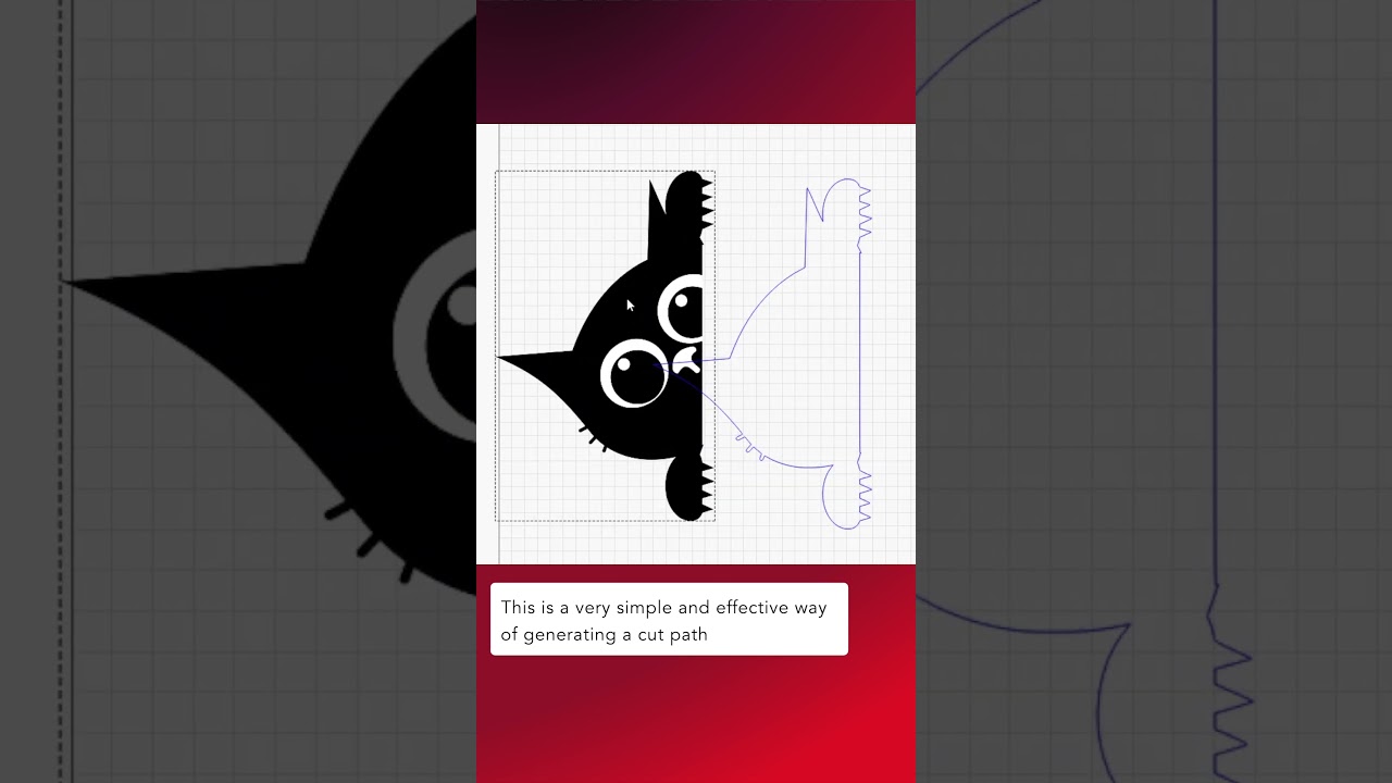

VIDEO: Quick Tip - Isolating an Image From Its Background
This week’s quick tip highlights the Trace Transparency function of the Trace Image tool.
While you’re likely familiar with using Trace Image to convert a Bitmap into a Vector graphic, Trace Transparency allows you to quickly generate a path of the transparent layer often found in PNGs.
This is incredibly useful for creating a perfect outline of your engraving that you can use to cut out the finished job, without the need to manually create one.
Simply set the layer to Line Mode , adjust your Speed and Power , and you’re off!
To find out more about the Trace Image tool, check out our documentation:
Trace Image - LightBurn Documentation
