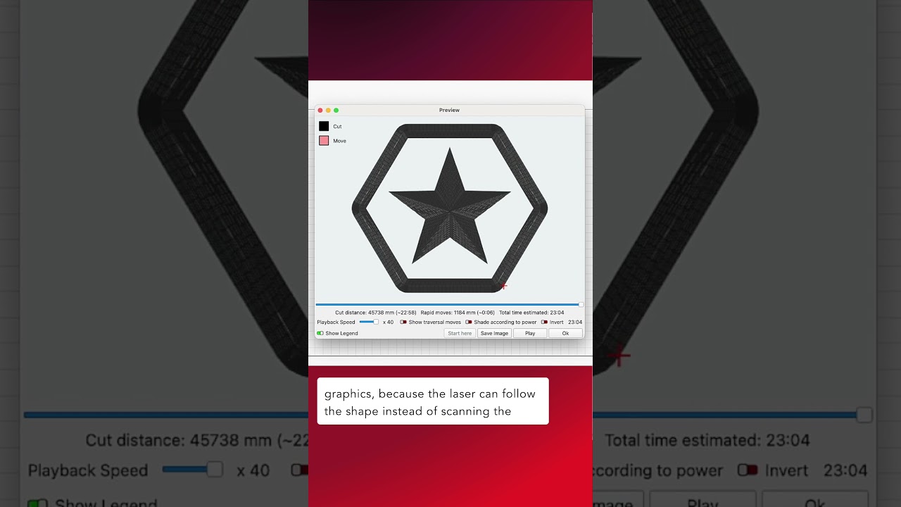

Offset Fill mode is a variation of Fill Mode that tells your laser to etch concentric lines following the outline of your shapes. It’s designed for graphics with a lot of empty space, to cut down on the amount of travel time needed.
