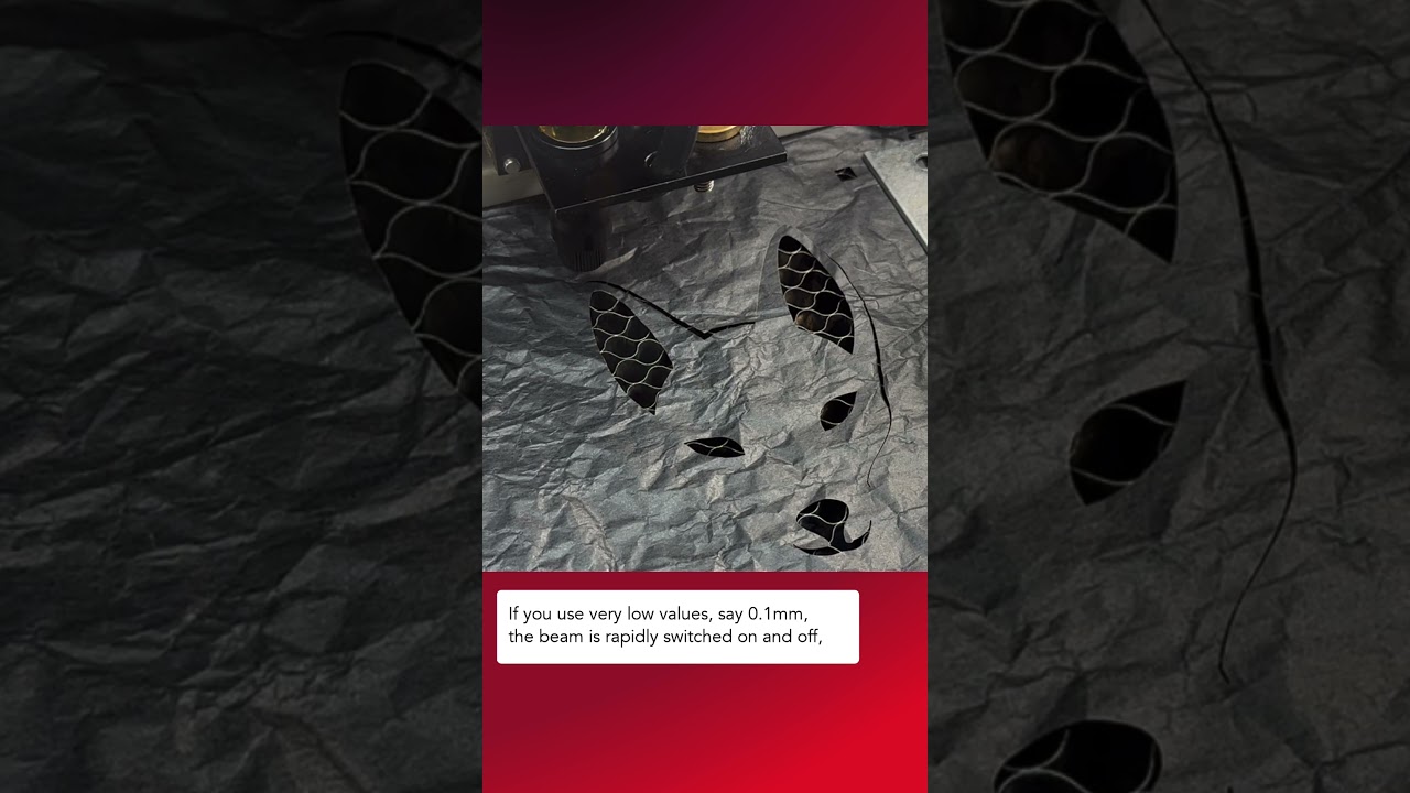

LightBurn’s Perforation Mode is a handy tool for automatically making dashed or dotted cut lines with your laser.
This feature is perfect for making tearaways, fold lines, stitching holes, and can even help you lower power beyond its usual limit so you can cut super-fine materials.
