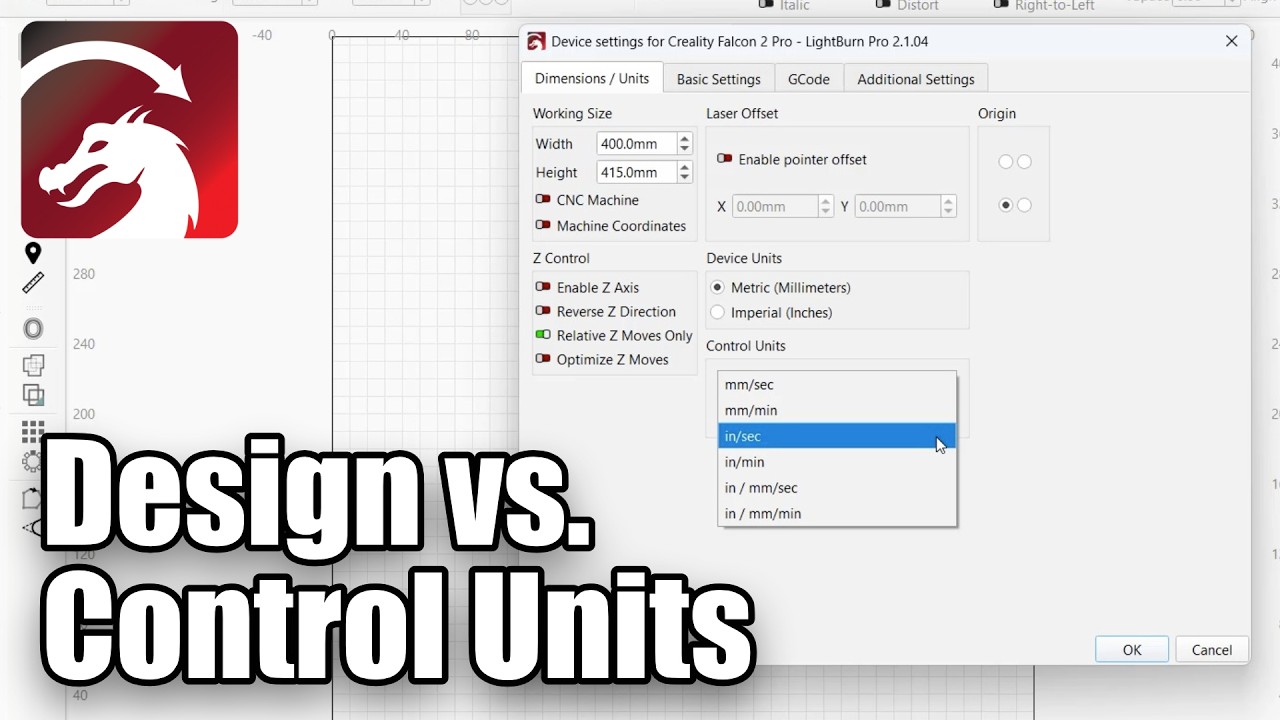

VIDEO: Understanding Design, Control, & Device Units
LightBurn has three places where units of measurement are defined - Design, Control, and Device. Design is what’s used when creating or laying out graphics in your Workspace. Control is used in the Cut’s and Layers window, and when jogging your machine. And Device is used to tell LightBurn whether your device expects to receive metric or imperial units.
Documentation on Control Units:
Device Settings: Dimensions / Units - LightBurn User Guide
Documentation on Design Units:
Settings/Preferences - LightBurn User Guide
Documentation on Device Units:
Blog post on unit settings changes:
PSA: Unit Settings Changes in LightBurn 2.1
LightBurn Tutorial Playlist:
https://lbrn.info/s1FJi
