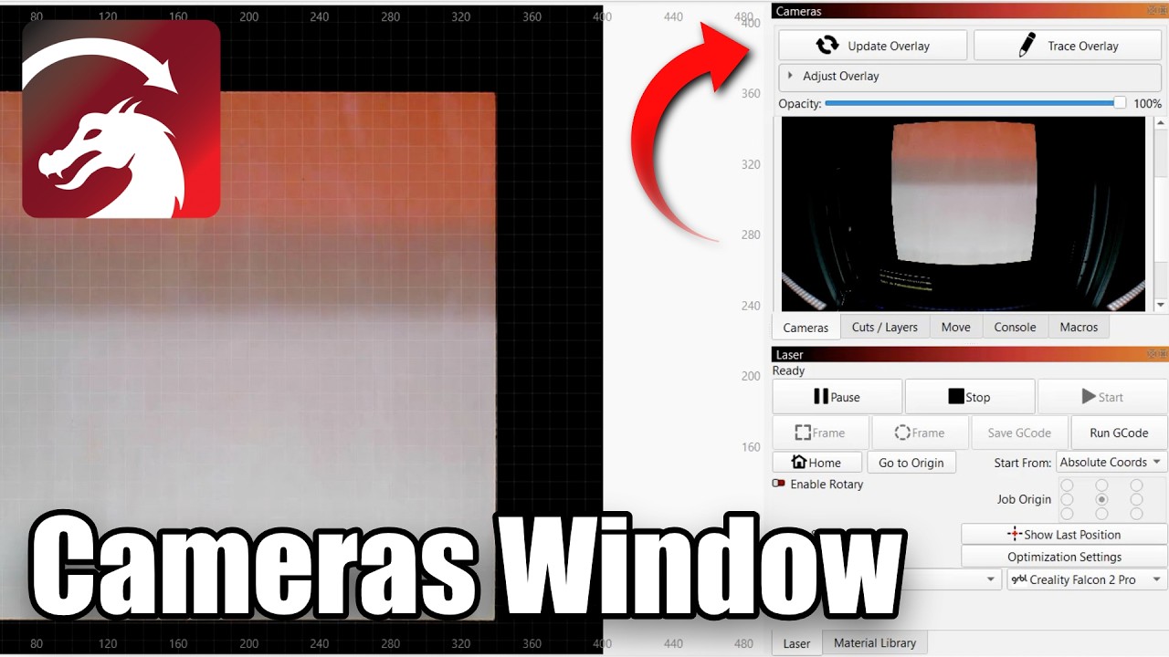

VIDEO: Using a Camera in LightBurn
Use the Cameras Window to update the image overlay in your workspace, trace a design from your laser’s bed, and adjust a number of camera and overlay settings.
Documentation on the Cameras Window:
Cameras Window - LightBurn User Guide
Camera Setup Video Playlist:

“Trace images captured by your camera”? Did not know that was in the toolbox!!!
Oh yes! It’s very, very handy.
I have an IPEVO camera on a gooseneck I could use instead of laying my paper in the laser bed. This will eliminate about 5 steps involving the printer scanner. Life is good!
Edit: I added the IPEVO, made a height stick, did a focus test with April tags, and used my alignment test burn for the Alignment. Now I have Desktop Tracing activated!
