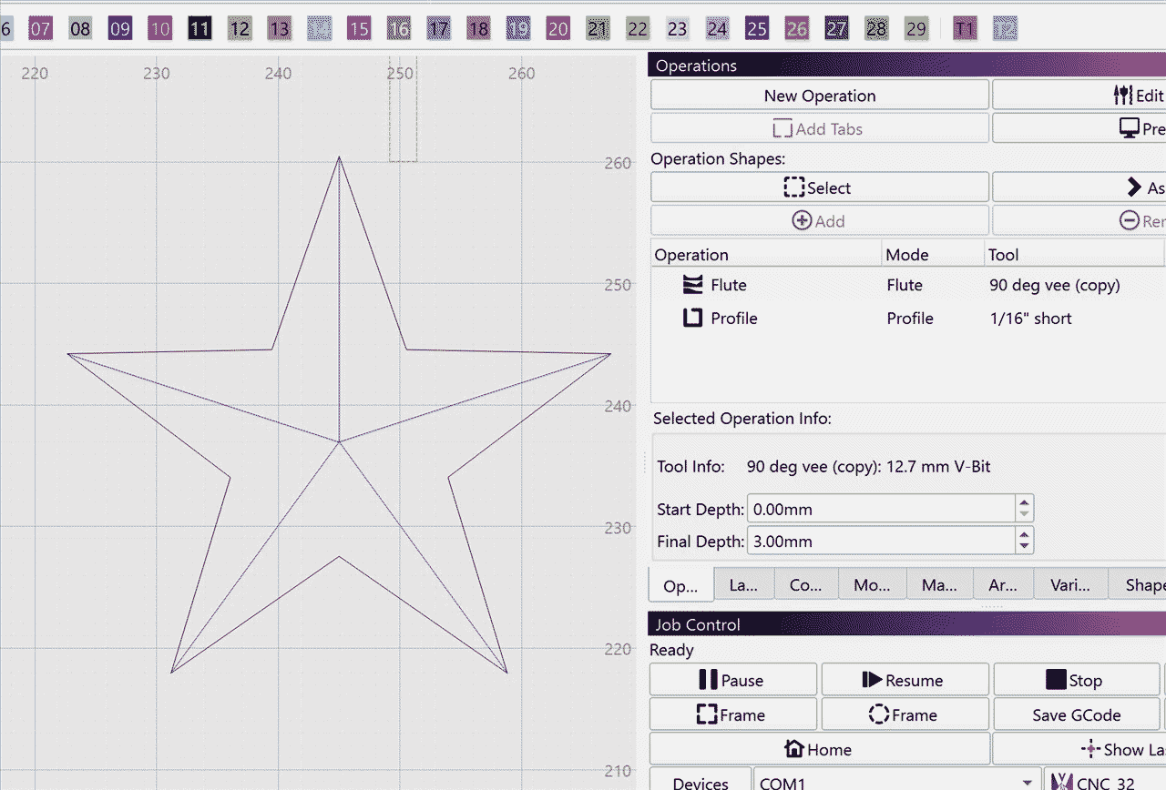

To check shapes :
For a list:
When the operation is selected, you see the assigned shapes appear with a thicker outline:
You can also right-click the operation and “Select the shapes assigned to this Operation”
Or enable “Auto -Use Layer” if that works for you.
You can easily see the shapes assigned to an operation, as Aaron explains above. There isn’t a simple way to do the reverse and see all the operations assigned to a single shape. We have the info, so we could do it.

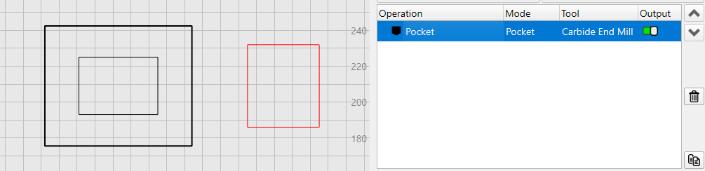

Just to add to the above solutions here is a trick I use and abuse. Select all your shapes then click each OP and you can easy see the Marching Ants in bold corresponding to each OP:
OP_188534
I believe this is not in the Docs so maybe tell @ClaudioD about it.
The matching ants appear when shapes are selected.
The bold shape outlines appear when shapes are in the selected operation.
So, it’s expected, but the combination of both probably isn’t called out.
