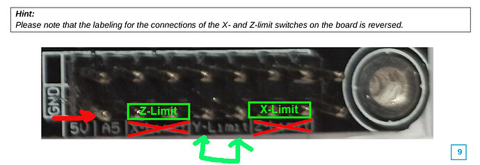

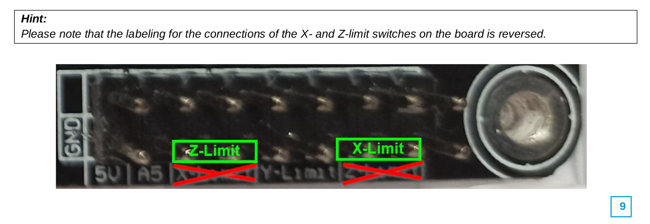

This leads me to the controller being a camxtool v3.* I downloaded the manual on the board and confirmed part of what we’ve stated… You should save this manual pdf in case you need it.
They knew this on my 2.4 board, sadly it’s still wrong…
The Reddit article is typical, bad information…
On this board, you need to use NO switches wired across the limit inputs… When the switch closes, it shorts the two pins pulling them low… one side is ground so it pulls the other pin low…
The schematic does not have a 3.3V output, so I have to assume that voltage you are reading is indicative of a problem.
My red mark is pointing at the ground pin… these are ground all the way across the bottom row of pins.
The green mark is the pair of inputs for the Y home/limit. Which you use is irrelevant.
This is the same chip that’s on an Arduino… 328p… they have internal pull up resistors that can be enabled via software…
Check the voltage between where the red ground mark is and the pin above it… You should get 5V. Unplug your switches and check from the ground pin to it’s input… all axes limits should also read 5V.
If these voltages read ok with the switches removed… then…
  1. is that you have the hardware connected correctly.
  2. Can you take a photo or give me a link to the switches you’re using and how you wired them?
  3. They should be wired so they make a connection when activated. These are NO.
