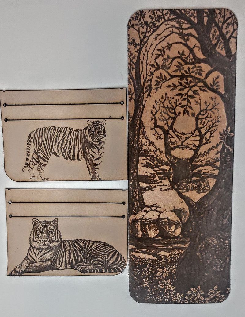

Decided I needed a new wallet after my granddaughter’s puppy decided the old one made a great chew toy, The key fobs are an example of what I make for some car dealerships in Alberta.
I really need to practice my photography skills. The look better than the pictures show.
The detail in that tiger is amazing! I will get in trouble if I comment on the key fobs. Am I safe assuming everything is done in leather?, And you make the tags yourself?

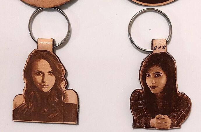

Both the wallet and fobs are in leather although I also make the fobs in faux leather if requested. I have also make them using 1/4 " teak as well. The leather ones are much faster to make because I put the same image on both sides. With the leather I laser both sides, add contact cement and fold it over. The wood ones require precision positioning to do the other side.
I started making fobs for a local photographer after I accidently ordered 1000 key rings from Alibaba instead of 100. I keep the scraps from other projects and these are small, fast and leather is much cheaper than teak, oak, cherry etc…
I find grayscale the best option for leather.
