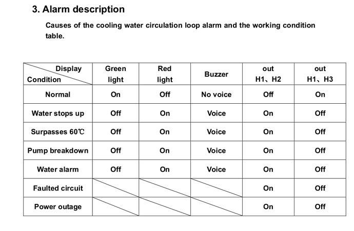

Don’t know if this helps, but it’s the 5200 series maintenance manual.
Good luck
Thanks for the manual that’s a very good idea. Fortunately I have an aquarium style pump that came with the laser when I bought it. I will use this in the meantime and hopefully by a process of elimination be able to source the actual problem. The chiller bought second hand has always beeped but in the past I have pinched the tubes and it’s then worked fine. Now it isn’t so no idea at the moment. As you say there aren’t that many parts to it so will no doubt spend to long on trying to resolve it.
