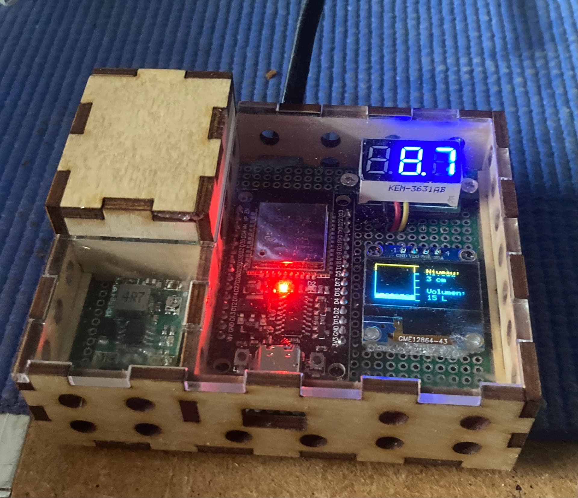

A nice little and practical project that I’ve been practicing a bit with.
It’s a water level control that works over the internet and visually with a display. An ultrasonic sensor and an ESP32 controller are used.
I’m relatively new to the wonderful world of electronics with this type of parts and it’s nice that my ugly soldering is hidden on the inside of the box :wink:
The control box has a little Velcro on the underside and is placed by the water tank in my RV. While I was playing with the small electronic parts and programming the gadget, I found a controller that will be able to handle it all in a quarter of the space my box takes up now, that will be another project…

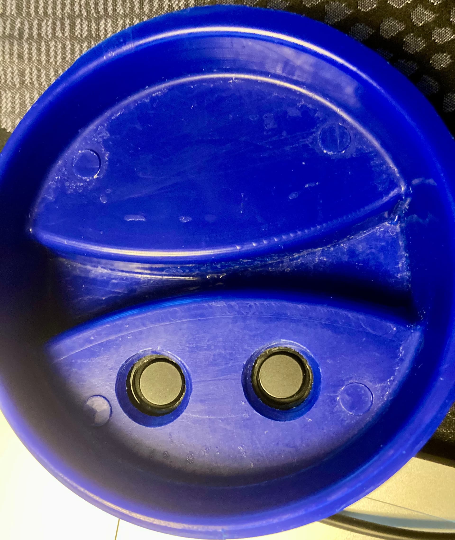

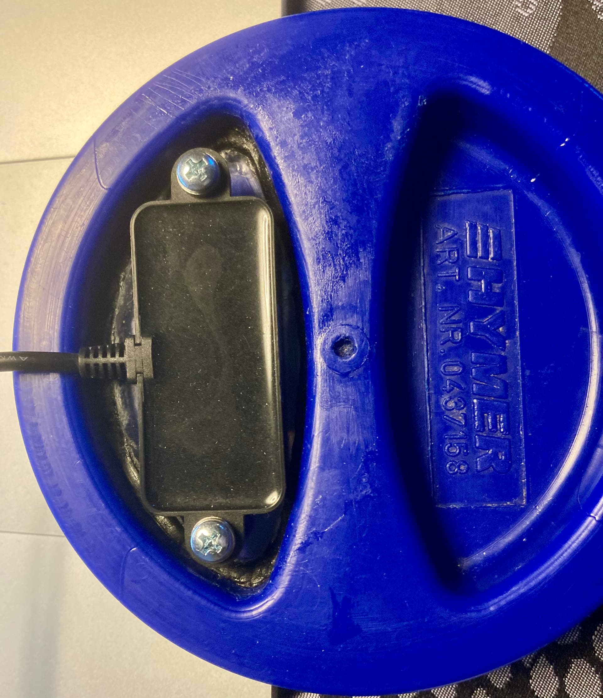

The box itself is drawn/made in LightBurn, it’s 3mm baltic birch plywood and 3mm Acrylic as a cover plate. Everything is (as always) a little too tight, so no screws or glue are used. :wink:
The holes (Ø12) for the ultrasonic sensor, I have also cut with my laser in the blue cover, it is PE approx. 6mm thick. The sensor is screwed to an acrylic plate which fits perfectly and tightly into the design of the tank cover.

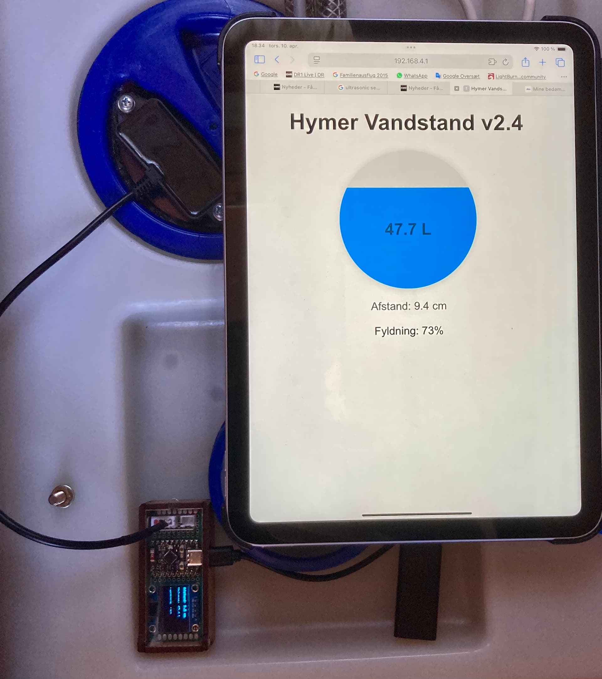

Here is a final update. The new smart distance sensor never worked for me, so it’s the original one that lives permanently in the RV.

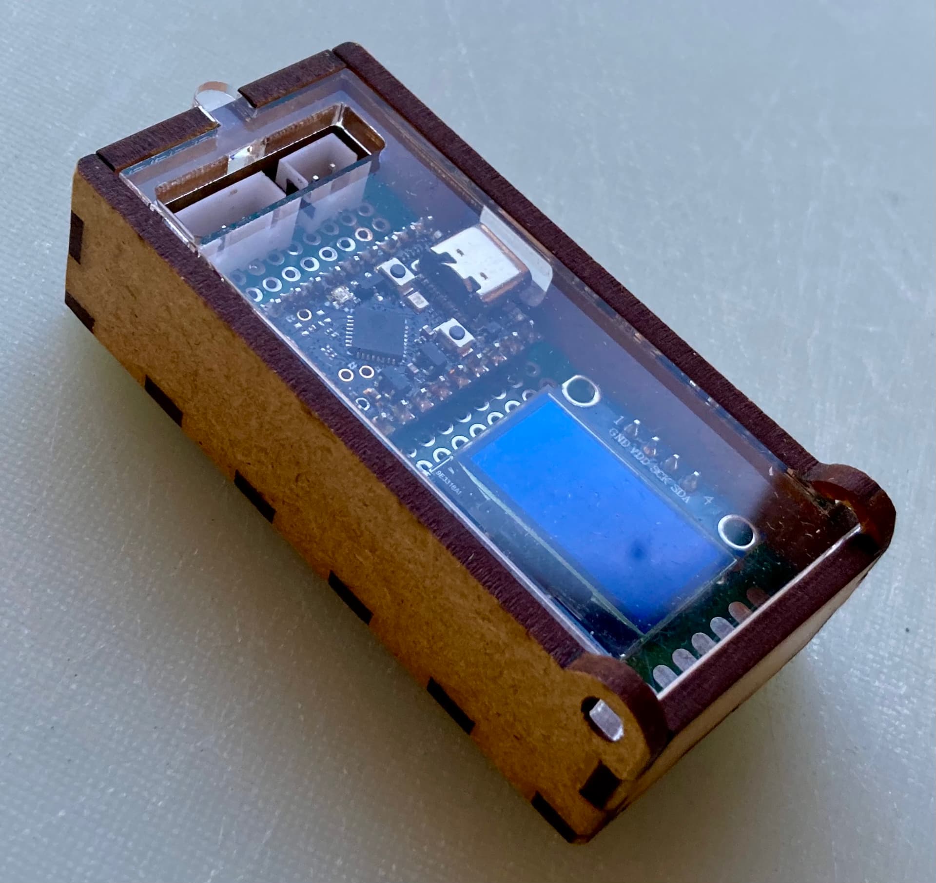

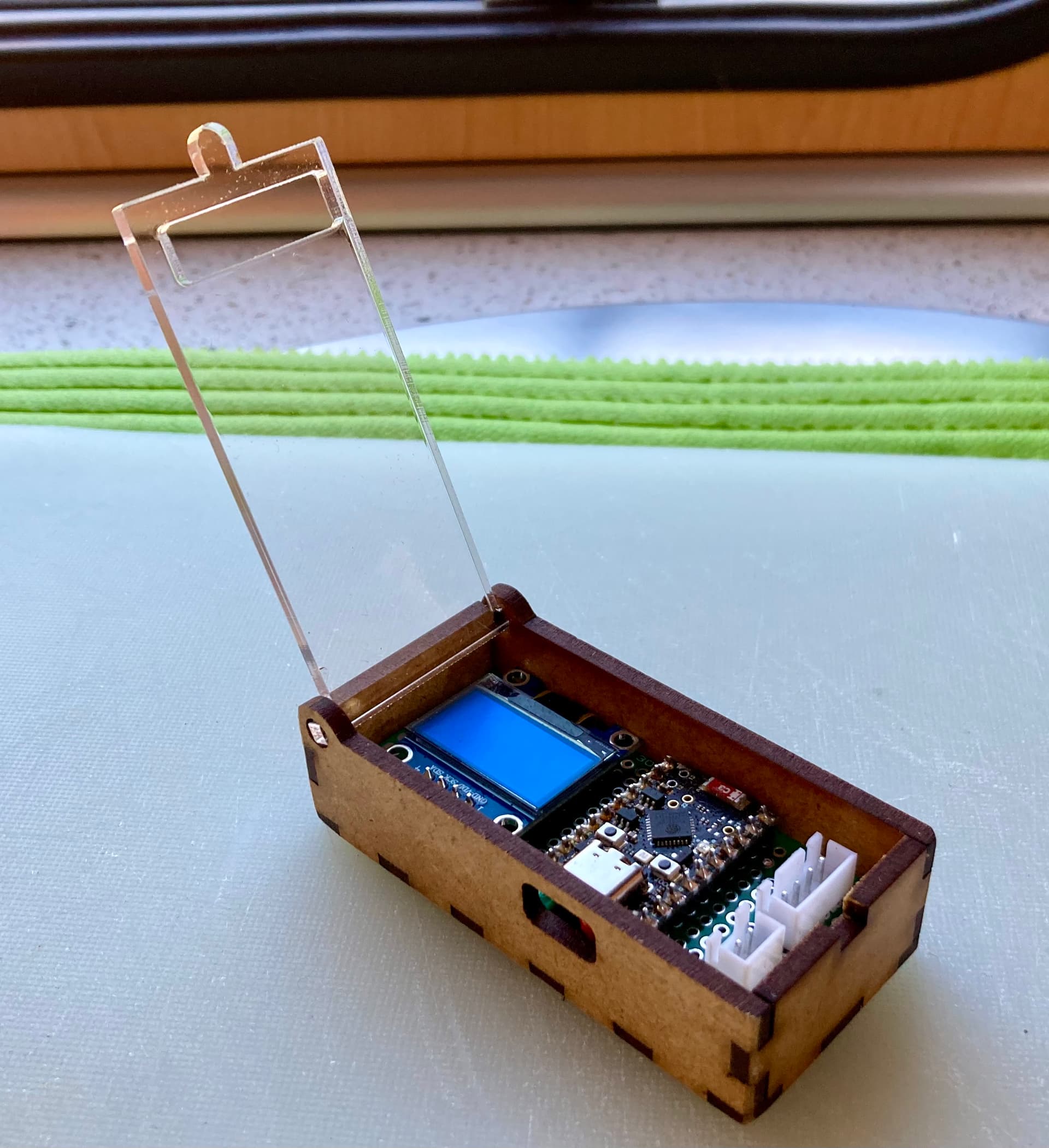

I have made a new small box, what started as a sample in MDF became the final version with an acrylic lid, it just worked and looks nice, I think. On the ESP32C6 I have connected the internal power management, now I have another extra option to supply the device with power. As you can see in the picture, I have a very simple but satisfying graphic display on my phone/iPad, the reaction time from start to reading the water level is about 4-5 seconds, that’s ok for me and in return the measurement is 100 times more precise than the original from Europe’s largest RV manufacturer.
The “packaging” itself is of course made in LightBurn, it takes me about an hour to draw such a project, it takes more time to measure than it takes to construct. I could manage with only 2 attempts this time.
