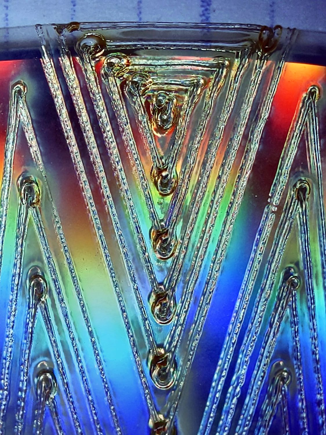

For example, a test pattern on a scrap CD-R started with the coolant at 20.5 °C, which meant the Min power of 7.1% didn’t quite fire:
Running the test pattern over the whole CD-R raised the coolant to 20.7 °C by the end and the Min power was firing somewhat better:
Raising the Min power to 7.5% produced a complete pattern on another CD-R, although with some thin sections:
