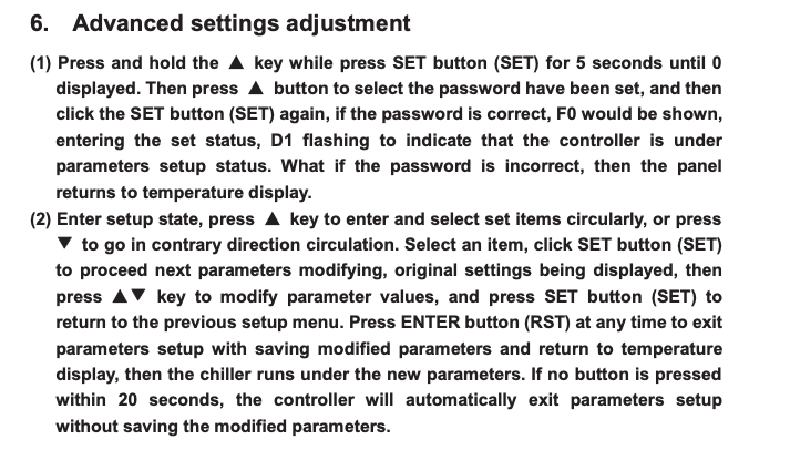

I sent a request to the company I bought it from yesterday. He replied with a generally different procedure for setting the temperature which I followed. The unit works as it should now.
Enclosed is the new instructions I received. Maybe help someone else.
  1. Press up and then hold set until 0 is displayed on the screen.
  2. Adjust it to 08, press SET, F0 appears.
  3. Adjust it to F3, press SET, 1 appears.
  4. Adjust it to 0, press RST.
  5. Press SET, and adjust the temperature to what you want.

Was the steps different than in the manual?
I had mine apart and could see the temperature control module, so I just got the information from the manufacturer.
Great it’s functional… that’s a major relief.
This is Directions from Manual:

After resetting according to new info the temperature stays within “0” to ".3°C of my 20°C setting
