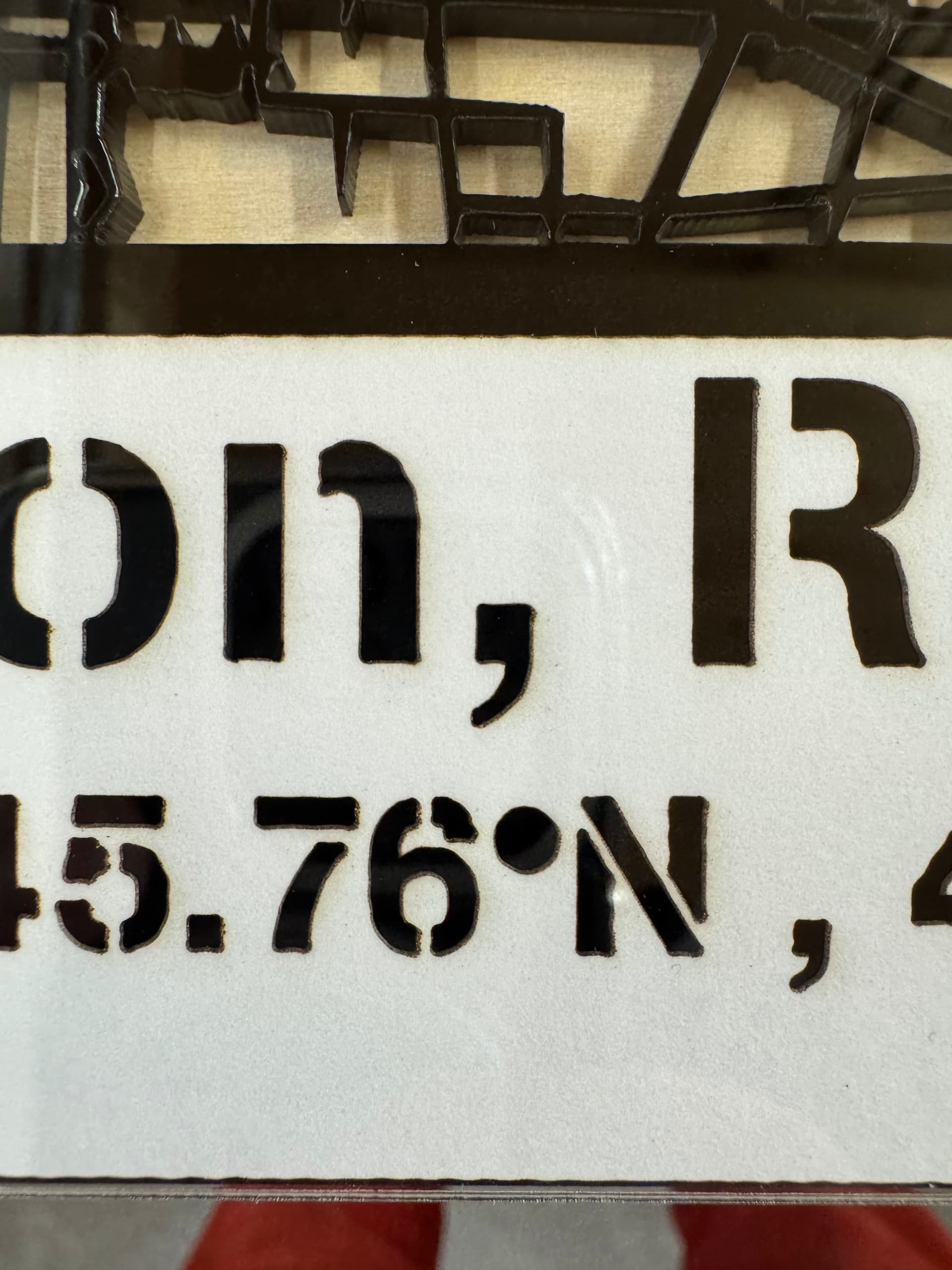

Hi everyone,
When I cut a straight line and even other shapes, my laser doesn’t produce a perfectly straight cut but rather a kind of wavy line.
Do you have any idea what could be causing this?
I’ve already checked several similar topics on the forum that might help, and I saw that people often recommend checking the belts and the mechanical parts that move the laser head.
I’ve gone through all of that but didn’t notice anything unusual, which is why I’m posting here.
I’m attaching a photo — you can see the waves not only inside the letters, but also along the top and bottom edges of the paper.
For reference:
  • I’m running the latest version of LightBurn, I cut at 50mm/s and 35%power.
  • I’m on a Mac,
  • And my machine is connected via Ethernet (following a previous thread, which actually solved quite a few issues — thanks again for that!).
Thanks in advance for your help and suggestions,
Marco
If you have checked your belts and pulleys (loose pinion screws are hard to see), then there is also a possibility of problems with the nozzle head itself or a loose/defective lens.
