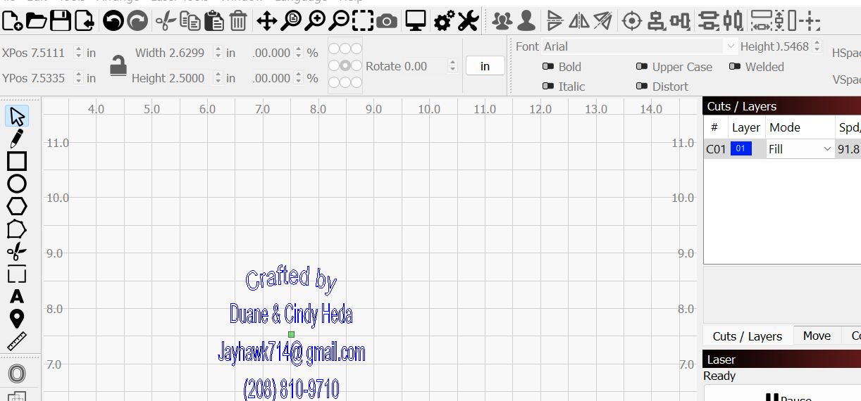

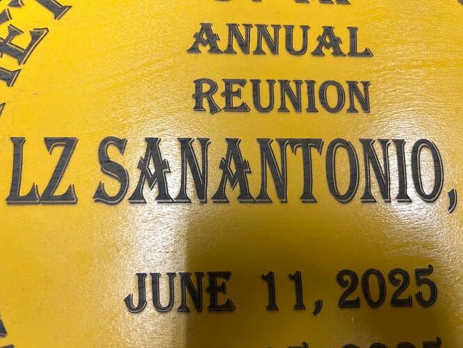

I am getting wavy lines in my burns and not sure why. I am running an Ortur LM 3 with their 10 watt laser. All three belts have equal tension. At first I thought the “Welded” option in the fonts options was on but that was not the case. As you can see it’s not every letter which adds to the problem.

Mechanical issue in the frame.
Cut your speed by 50% - does the problem get any better?

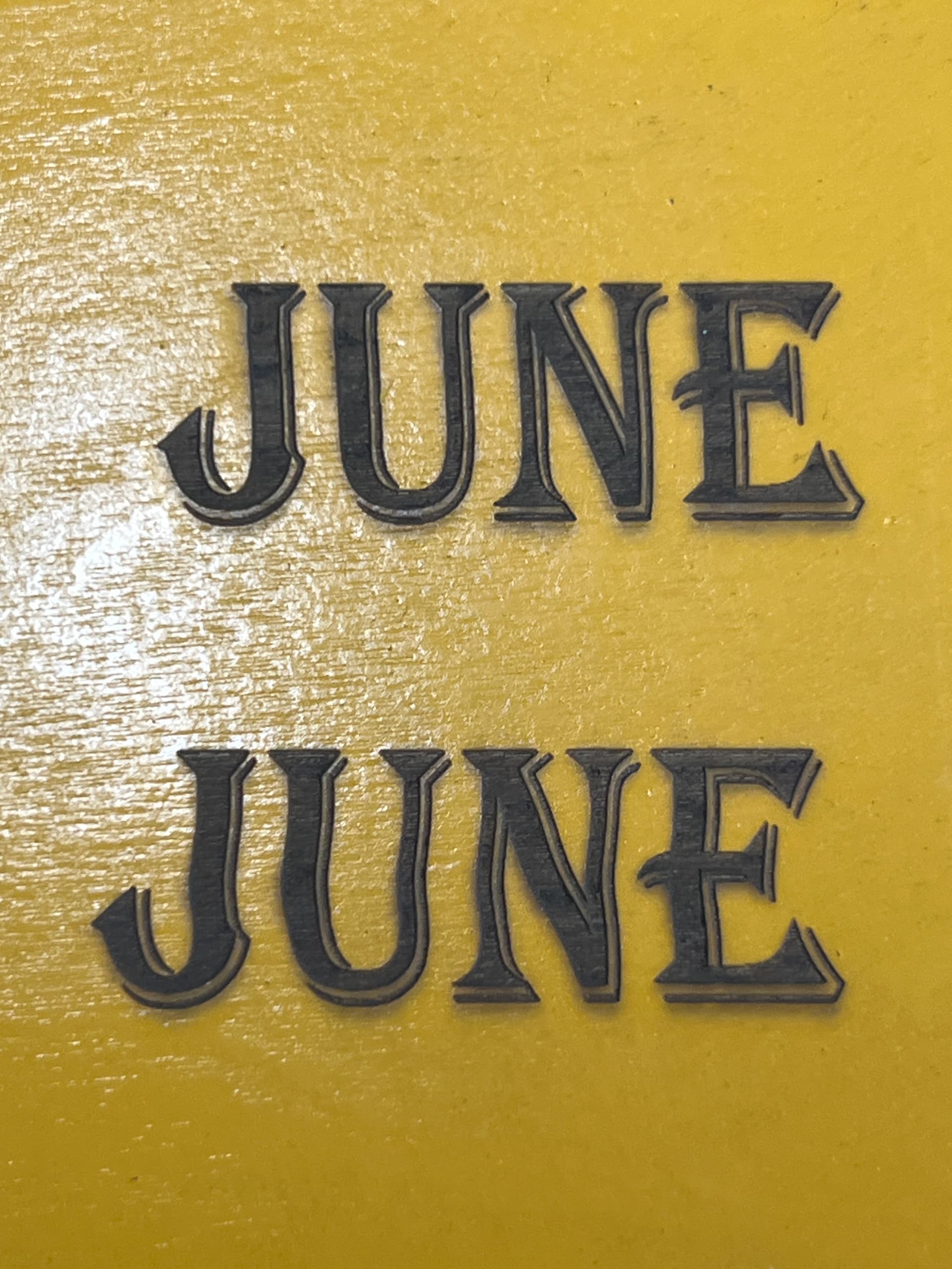

Here is the result of the test. This was at 400 in/min, two passes. Sure looks like a mechanical problem. Unless you have something else to suggest I am going to pull out the assembly instructions and go step by step to hopefully solve my problem.
Claude, the side were they are suppose to be and tension is good. I’ll check the gantry belt for tension and also the pulley set screws as I go through the whole machine.
Horizontal lines with waves in a sinos wave shows vibration, or “ringing”. Check your set screws that hold on the shafts. Those are tough to get and keep right. Is your table secure? Do you have a camera hanging off the frame that could be acting as a tuning fork?

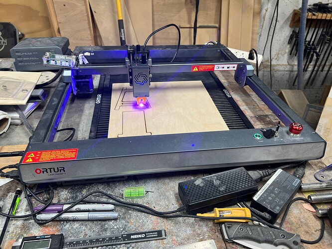

Maybe a quick photo of you physical set up would help?
I slowed the speed and it did help a lot but still need to find the root cause of the problem.

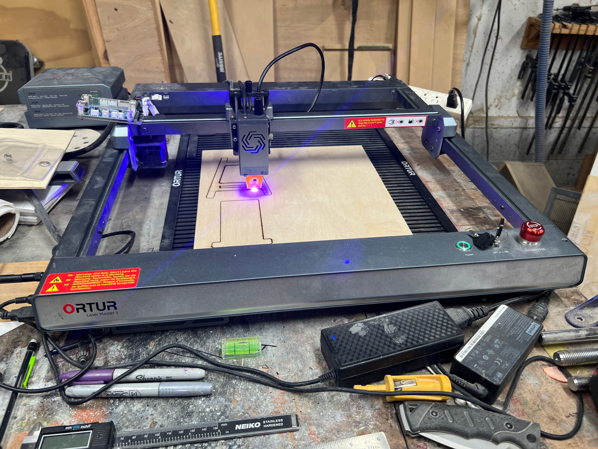

Try to look past my mess! Need to do some spring cleaning. :grin: :upside_down_face: Did not have time to work on the machine yesterday and won’t until Monday it looks like. Here is a picture of my setup. The unit on the left side of the gantry is for running my 20 watt laser.
What speed are you running?
Top speed from data sheet is usually fairy tale catagory. My speedometer on my Altima goes to 140 mph - and that aint ever gonna happen unless it’s dropped from a cliff.
I suspect that you have a wobbly table or your frame has come loose -or- your laser head is loose on the gantry. The error does not manifest on the Y axis, leading me to the gantry/laser head as the source of the sinusoidal aberration.
