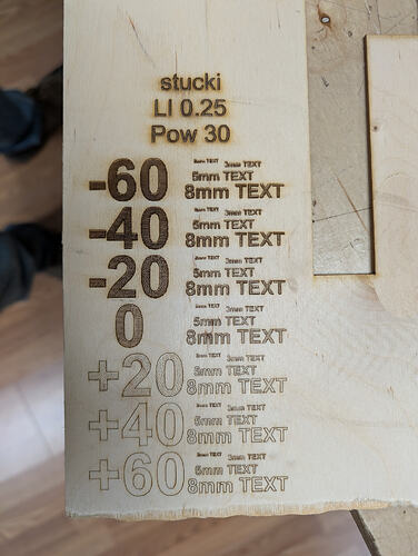

In my experience, the Materials Test for fills is almost pointless. For the most part, the appearance is very similar to any burn method with the same power product=power/(speed*line interval).
Start with a reference square.
Beside it, halve the power, but halve the speed too.
Beside that, double the speed, but halve the LI.
These all look basically the same, so you might as well kick power up to 100%, LI to like 0.8-0.5 the spot side and just go lighter or deeper by adjusting speed alone.

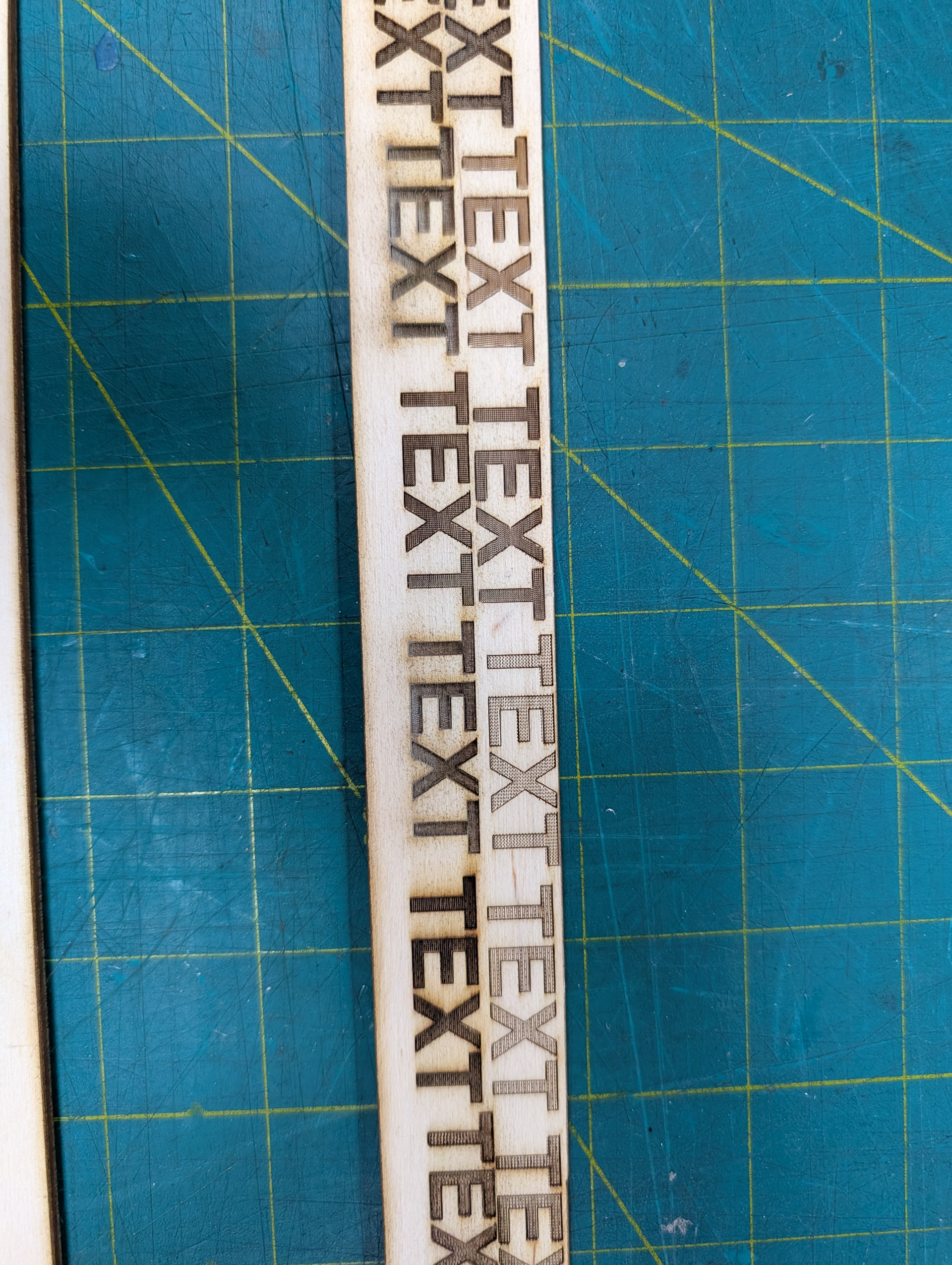

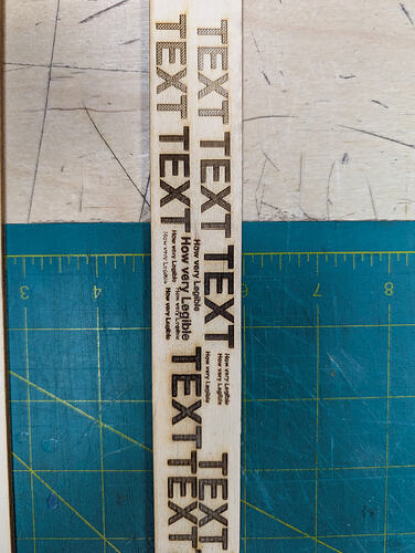

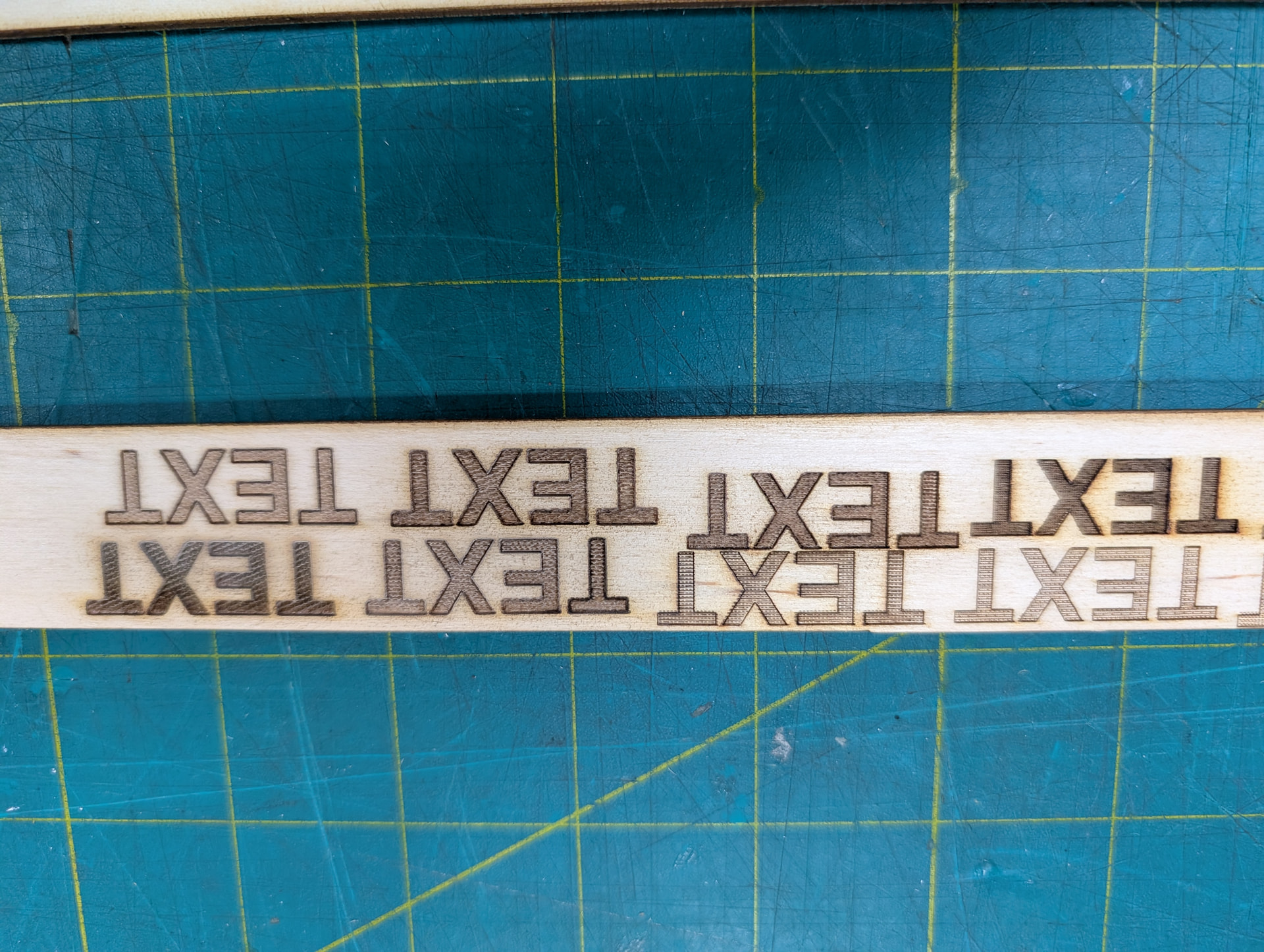

I was thinking about the texturing problem and it occurred to me- why not just shoot “static” to the power to fuzz up the bottom?
I ran with the idea and realized I was basically thinking of dithering a gray background, and do “Apply Mask to Image” with filled text or whatever.
I must say, there are plenty of cases where it works EXCEEDINGLY well. It can do a LOT of interesting appearances, generally darker than you’re used to seeing because of the extra surface area, AND they may leave a clean top surface because it’s not actually removing as much wood overall.

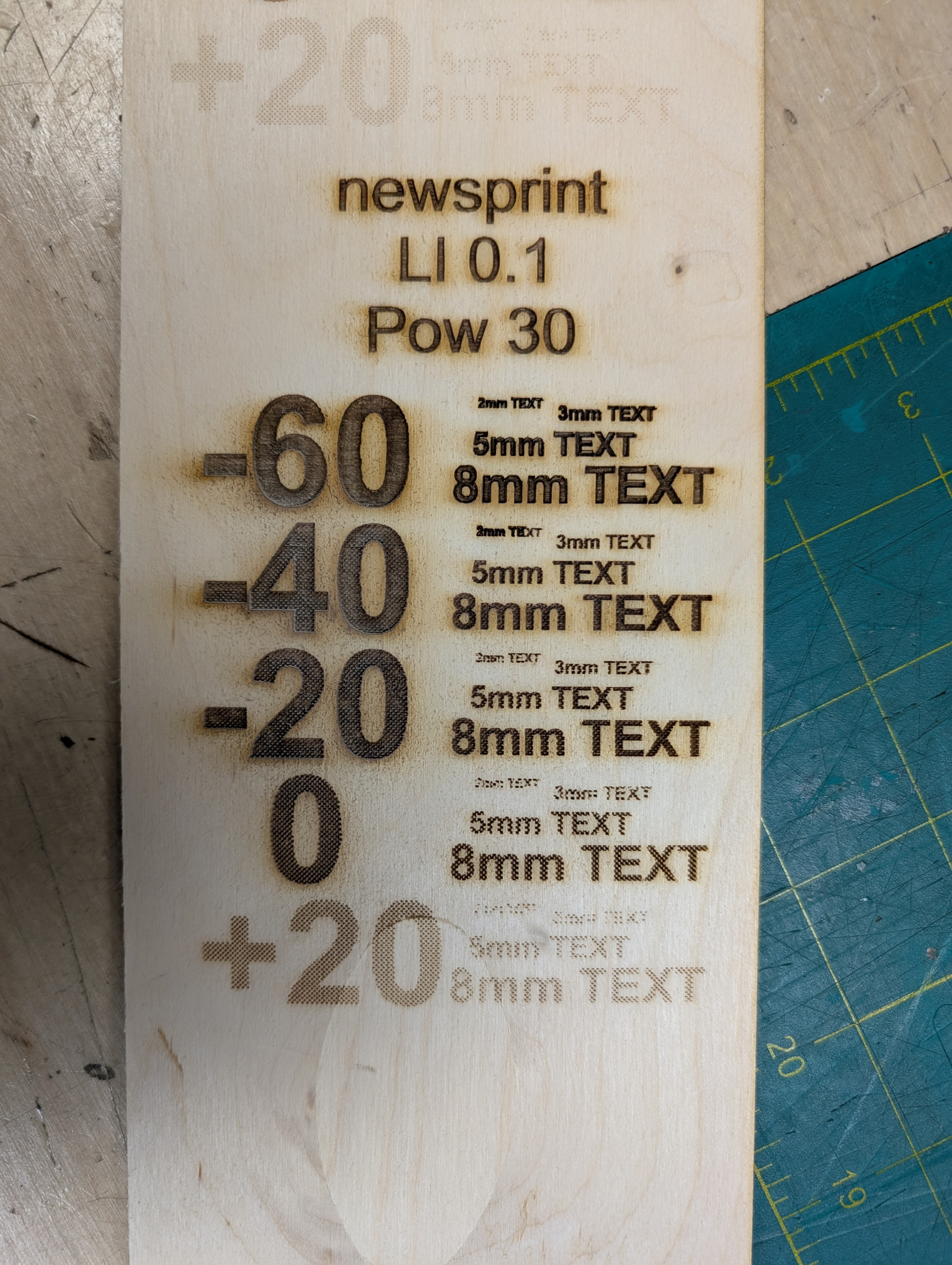

There’s a lot of dimensions of control here:
dithering type
The shade of the background to fill with. Note that going from 25% black to 50% black is NOTHING like doubling the power or halving the LI or halving the speed. Going to 100% black would be pointless as it’s no longer dithering, it’s just an ordinary fill again.
speed, power, LI.
LI has dramatic effects on the appearance. If you get it near the scale of the laser’s spot size, you can get the dithering pattern to be prominent and it looks way cooler than regular fills.
Power has surprisingly little effect in many cases. It’s because it drills a series of little holes and more power just makes them deeper, but not much wider or darker.
In these tests I made a rectangle around the text I wanted to texture, change to Fill, do “convert to bitmap” which gets you a 50% gray color on an Image layer. From there I tried different Brightness +/- numbers to try different shades.
Make text, set to Line, and use the same layer number as the Image layer. So you’ll have like a red 02 layer for Image and a red 02 layer for Line.
Select text and bitmap-gray, “Apply Mask To Image”. You will get a much better look if you do a Line engraving around the border. I skipped that in most of these tests due to a time crunch.
Unfortunately there’s an absurd amount of other “gotchas” and trying to make a reusable test pattern kept slowing Lightburn to a crawl (like 30 sec to do any operation…. ANY operation). Threw an Exception fault too.
It’s got some great looks, and people are already asking me about it, but as simple as this seems it is over a dozen processing steps.

If you want to try this, here’s how it goes
  1. Make your graphics. Bolt Arial text 6-12mm high looks great
  2. On a different Layer, make a rectangle around all the text you want texture filled (actually it’s possible to make the rectangle on the same layer as the text, and it will end up creating both an Image and Fill/Line Layer on the same Layer number, but there’s drawbacks to doing it this way). This Layer MUST be FILL not LINES. If you only get the outline of a rectangle on the bitmap, it’s because you used LINES.
  3. Select the rectangle alone, do “Edit→Convert to Bitmap”. This will make a 50% black solid. I’m not sure if DPI resolution matters or not. If it does, sliding it high will be better but may slow down LB. This will create an Image Layer on the same Layer number the rectangle used, alongside that original Lines/Fill layer.
  4. Select all the text or any closed shape graphics. The next step is ONLY going to make that function available if everything you select is ONE object in Lightburn. A line of text is one object even though it’s made of multiple closed shapes. But if you click elsewhere and make another line of text, or anything closed, they are two separate objects, and LB will not allow the next step. To fix this, once you have everything selected, select “Group” and that turns it into one object
  5. Change the original Layer you put your text on from FILL to LINE (required. you can’t fill a Fill. you can only fill Lines. Because that makes sense.
  6. Select both the 50% gray Fill rectangle and the single line object of the original graphics
  7. Use Tools→Apply Mask To Image. If it’s not available, it may be because you have more than one vector object or more than one bitmap object. See the “Group” thing in step 5. Also you may have selected the rectangle that made the raster gray rectangle
  8. Set up the Image Layer settings. Atkinsons/Stucki/Dither/Jarvis don’t look all that different to me. Ordered and Newsprint/Halftone can look a LOT different. The Line Interval creates very large differences in appearances. An LI similar or slightly larger than the spot size- like 0.2mm- often looks good. It can look REALLY good to go slightly over the Line Interval, which makes thin vertical walls that have a lot of surface area to turn surprisingly black. So, large LI does NOT universally mean it looks lighter. Large LI does not look good for thin features, it becomes spotty, but that will look excellent again if you also engrave the original line around it. If you use Halftone, Cells Per Inch and Halftone angle are now changeable options and it does affect the look of the output.
  9. You can select the raster and change it as long as it’s visible. Even if Apply to Mark cut it into 100 pieces, the actual raster is still there as a single object and you can modify it which affects all the pieces. You can do Adjust Image on it to adjust Brightness. Like I say, the original 50% often looks great. About 20%-70% gray is usable. Lighter % gray does NOT mean the final look will be lighter. It can be emphasized by using more power and/or smaller Line Interval.
  10. FINALLY. Select the raster rectangle in Image Layer to burn that. Also, optionally, output the Lines that made it and increase Speed and/or decrease Power so it vector engraves the outline instead of cutting through. This is very helpful IF you used a large LI and/or a lighter shade of grayscale. It may look unreadable without it, and look amazingly good WITH it.
