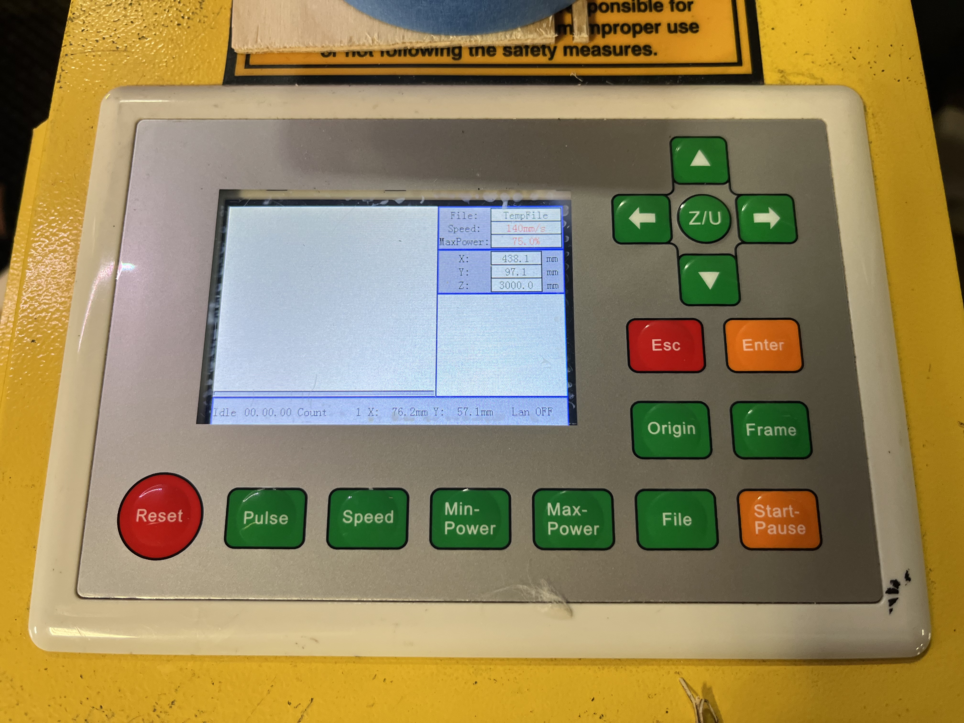

60W Chinese body - Ruidia Controller
Been using this laser for over a year. We noticed the laser losing quite a bit of power over the past couple of months.
We figured it had to deal with mirror alignment. Welp, after spending the time getting the mirrors aligned, the problem persists.
My engraving speeds before problem -
Speed: 300mm/s
Max and Min Power: 50%
Those engravings turned out amazing.
Now, using those same settings… the laser engraving still leaves glue from the transfer tape applied on top of the 3mm Birch Plywood. The depth of engraving is much less than before this issue started as well.
Cleaned the mirrors as well. Aligned the laser vertical from the laser head as well. Tried firing a few laser pulses from different focal depths and the laser beam hit the same spot. Went beyond a 50mm focal depth and was still dead on.
Taking a look at the laser tube itself… it makes me wonder if our laser tube is the main problem here.
The laser tube is dirty on the outside with dust. The inside of the laser tube though… looks quite dirty. Could this be part of our struggle?
I have also seen a few articles about power supply being the issue but not sure how to test it on this machine.
