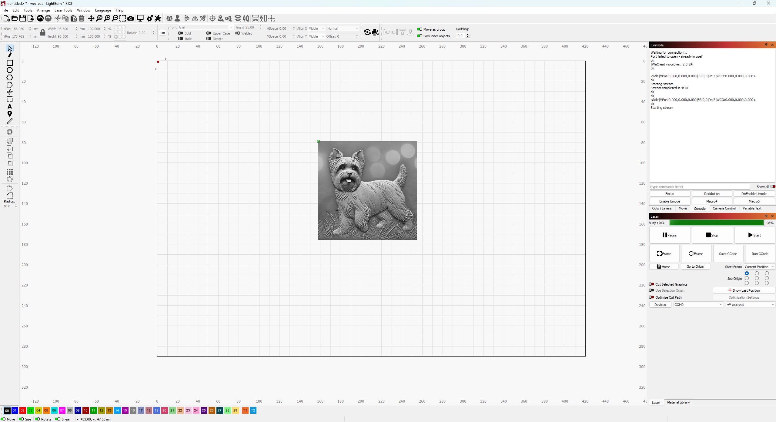

When I try to Frame and press frame nothing happened. It just says busy. When I press Start it will fire up the laser and move a little bit. I have checked the settings to what I have seen people post in the forums and they all match. I can not get the laser to go to the start positions to engrave. I have replaced the cable from my PC to the Wecreat, I have tried uninstalling and reinstalling both Wecreat software and Lightburn. Lightburn and the Wecreat are communicating but not fully or the way it should. I am at a loss. Thank you.

  1. Full screenshot of LightBurn with a file loaded that you’re trying to burn

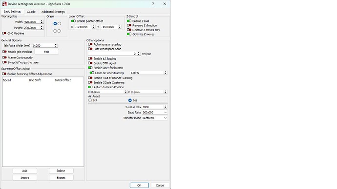

  2. Screenshot of Edit->Devie Settings
  3. Copy and paste full content of Console window after connecting the laser and attempting to frame

Device Settings
Image I am trying to engrave along with Console Window attempting to frame.
Thank you
The console dialog seems to indicate that you’re running version 2.0.24 firmware but that message may not actually indicate firmware. Let’s assume for the moment that you have correct firmware.
In terms of behavior, I don’t see anything too unusual in your Console window. Are you saying that the status in Laser window always shows as Busy and never completes for a framing operation?
I do notice some variations of Device configuration in your screenshot vs what the supplied configuration should have given you. Did you make any manual changes?
Can you make these adjustments and test again:
  1. Disable “Enable Z Axis”
  2. Enable “Relative Z Moves only”
  3. Disable “Optimize Z moves”
  4. Disable “Enable laser fire button”

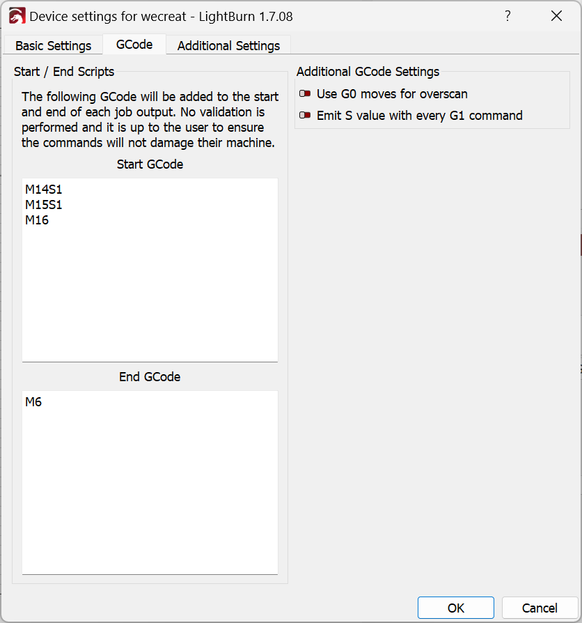

Also, please check the “Gcode” tab in Device Settings. Compare to this screenshot. If it doesn’t match, change to match:
Do you get any change in behavior after making these adjustments? Seems to me that the basic communication to the laser is at least working correctly.

I have made all the adjustments and it is now working.as you listed and everything is working as it should. Thank you kindly.
