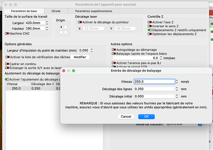

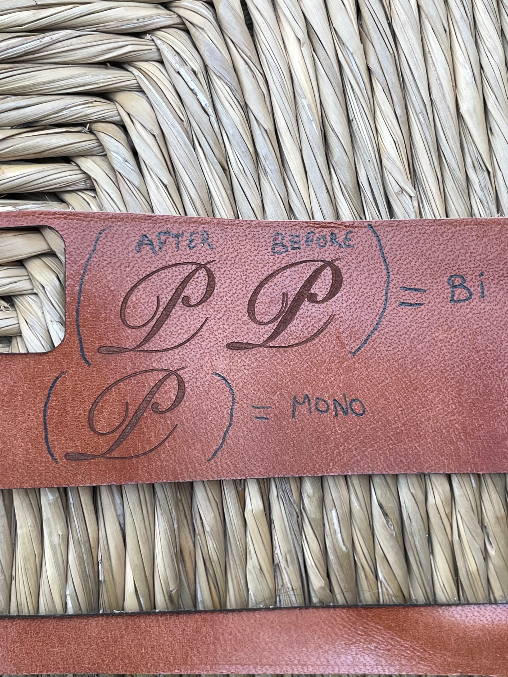

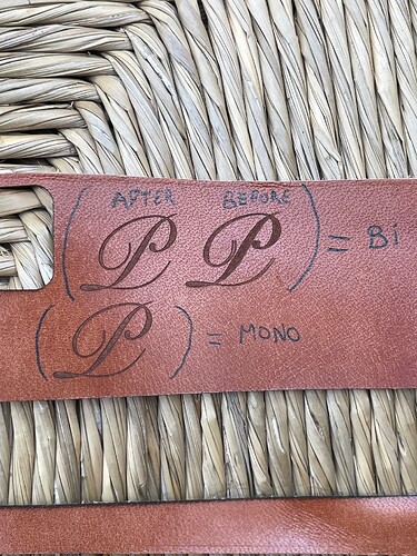

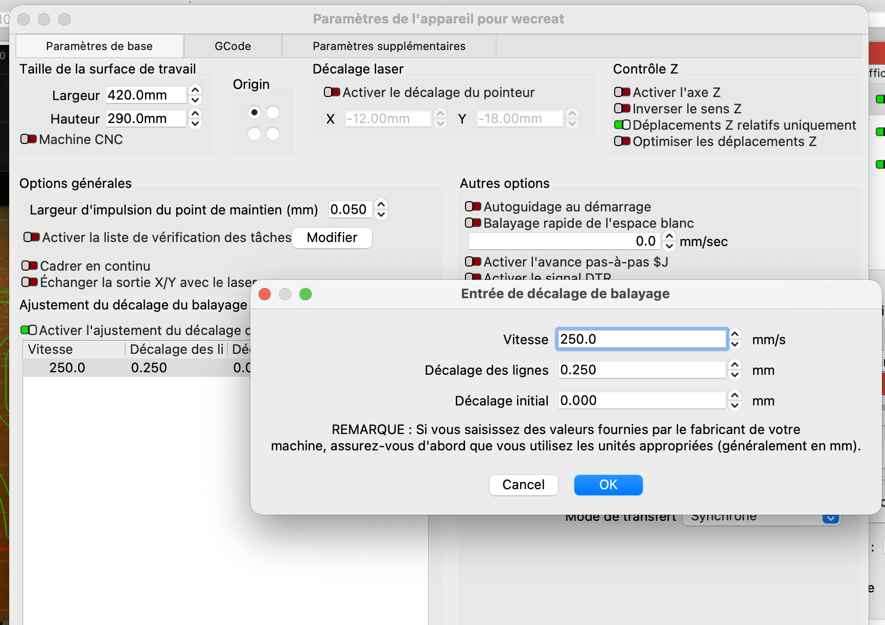

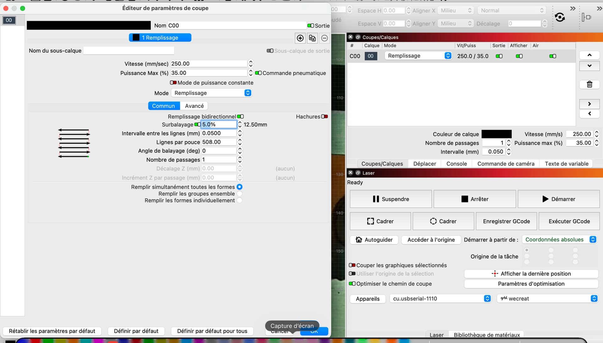

First of all, a huge thank you Tim and Aaron ! Indeed, the advice you gave me allowed me to solve the sharpness problem of the bidirectional engraving. I applied a line offset of 0.25 mm for 250 (mm/s) and increased the overscan from 2.5% to 5%. I will still refine the settings slightly, but the result is already very good.
