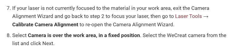

The camera should be aligned according to our instructions here:

When following our WeCreat-specific camera instructions, I’m not sure if step number 5 is still the best solution, now that we have a better way of calibrating the lens with the AprilTags and tracking
The important part of that Documentation page is step number 7.
Because, on the Vision, the camera moves up and down with the laser.
Note, that the camera can only be accurate at the height it has been calibrated at., and you will need to engrave a new set of the four target markers each time, if the pattern was moved.
