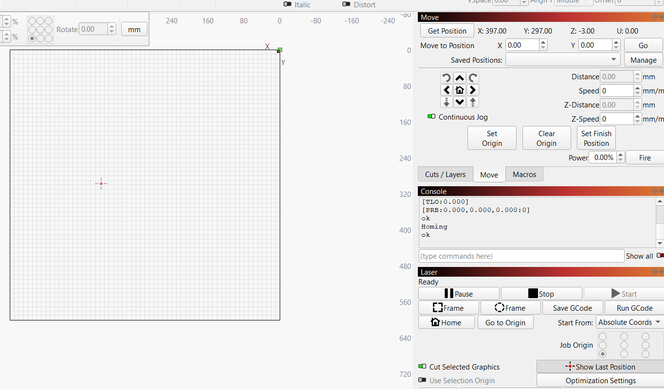

here is what I’ve done - after the $23=3 - it was still weird, so I restarted everything… it seemed to be acting correctly, except I noticed when it was “home” (bottom left), the crosshair was near the middle of the work area - so I did G92 X-597 Y-597 (it’s a 600x600 with 3mm back off from limit switches) - this put the crosshair in the bottom left, and after first test, everything works… gonna restart again and see what happens… was the last step I did to reset 0 a mistake?
Ah, yes that would do it.
Just restart and it should work the G92 is temporary.
yes, the g92 was temporary - after restart it’s back thinking it’s in the middle of the work area when it is at home - see attachment
To fix the weirdness you will need to enter:
$130=600
$131=600
done - restarting everything
wow - we might be fixed… I thought I had set the 600x600 in device and machine settings… what steps should I take to backup everything - just like i did before and maybe screen shot the device settings?

so this morning I turn everything on to start a 3.5 hour job.. didn’t have time to do it last night. and of course it’s messed up again. have restarted computer, controller, etc.. even loaded the saved machine settings.
It’s homing to bottom left, but cursor says it’s at top right and controls are reversed.
After all the changes you made yesterday did you change the machine origin in device settings to front left? This is a change you have to make in LightBurn. The grbl settings don’t change this. https://forum.lightburnsoftware.com/uploads/default/original/3X/4/3/436efde30c6204ee4ec621f04ebe1c6ea506f803.png
it was set for back right - i took screen shots of all the config pages when it was acting correctly. After seeing your note, I changed it to front left, it is now homing to front left, but up/down move is reversed, and left/right move is reversed.
