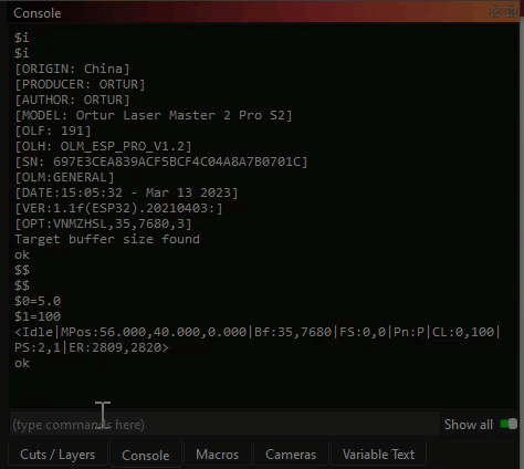

Please go to your LightBurn>Window>Console, and enter these commands, one line at a time, and press “enter” after each:
$i
Select All, and copy (right-click to copy) the results from the Console Window, and paste back here, it’s easier to do it this way instead of copying screenshots;
2026-01-16_16-26-17

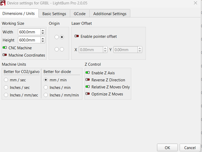

But please also include screenshot of your Device Settings>Dimensions/Units settings.
If you start homing this time with the laser head in the middle of the work area does the Y axis start to move toward the front? and then fail after it has reached the limit switch? or does it throw an alarm immediately without moving a jot?
Doublecheck the Y axis limit switch; if you enter ? into the console while you manually activate the limit switch you should see ‘PN:PY’ in the status report, and when not activated, you should see only ‘PN:’ or ‘PN:P’;

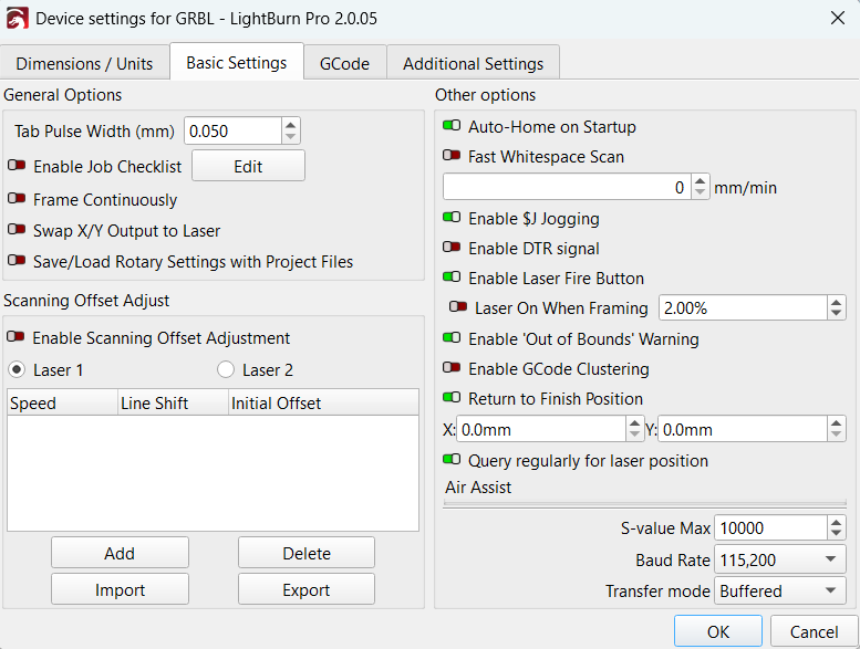

UPDATE: things appear to be working normally, but I am getting the ‘out of bounds’ warning, even though nothing is out of bounds. I see the option to disable the message, but I’d rather know/correct a problem that it thinks it has. Ideas? I have confirmed lightburn is set to 600x600 in device settings and in machine settings.
UPDATE2: Everything seems to be acting as I’d expect. I only use ‘start from current position’ until I can look more into the others… Also, if I enable ‘continuous jog’, left and right are reversed. They are not reversed unless I enable that..
So - the out of bounds warning and the ‘continuous jog reverses direction’ are the only issues I’m currently having.

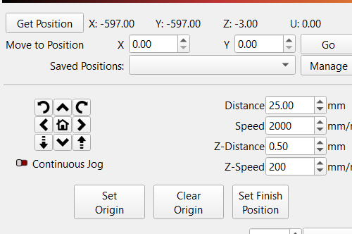

After homing, click on ‘Get Position’, in the Move window, you should see zeros.
So my steps should be - enter that command, then home the machine? Or home then command?
Enter the command, then home the machine and check the position and the “Show Last Position” should be correct.
I get -597 -597 -3… It does have a 3mm step off of the limit switches.
normal jogging is still normal - continuous jog only goes right (right and left both move it right) and up (both up and down move it up) - this is X Y I mean.

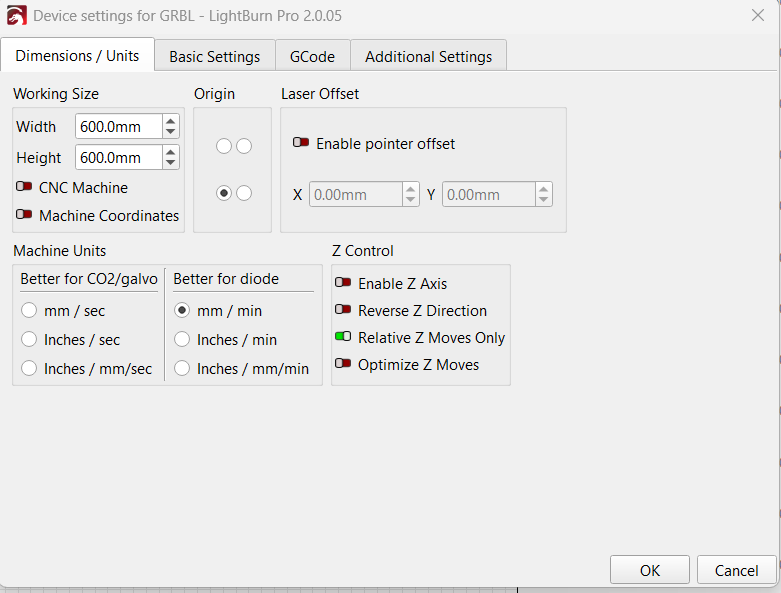

Hi Jeff,
Are your device settings still the same? Should be like this?:
This is what they were - I have changed them to match yours.
(same info I included in email to Lightburn support and FoxAlien support - hoping for consistent messaging on what to try next)

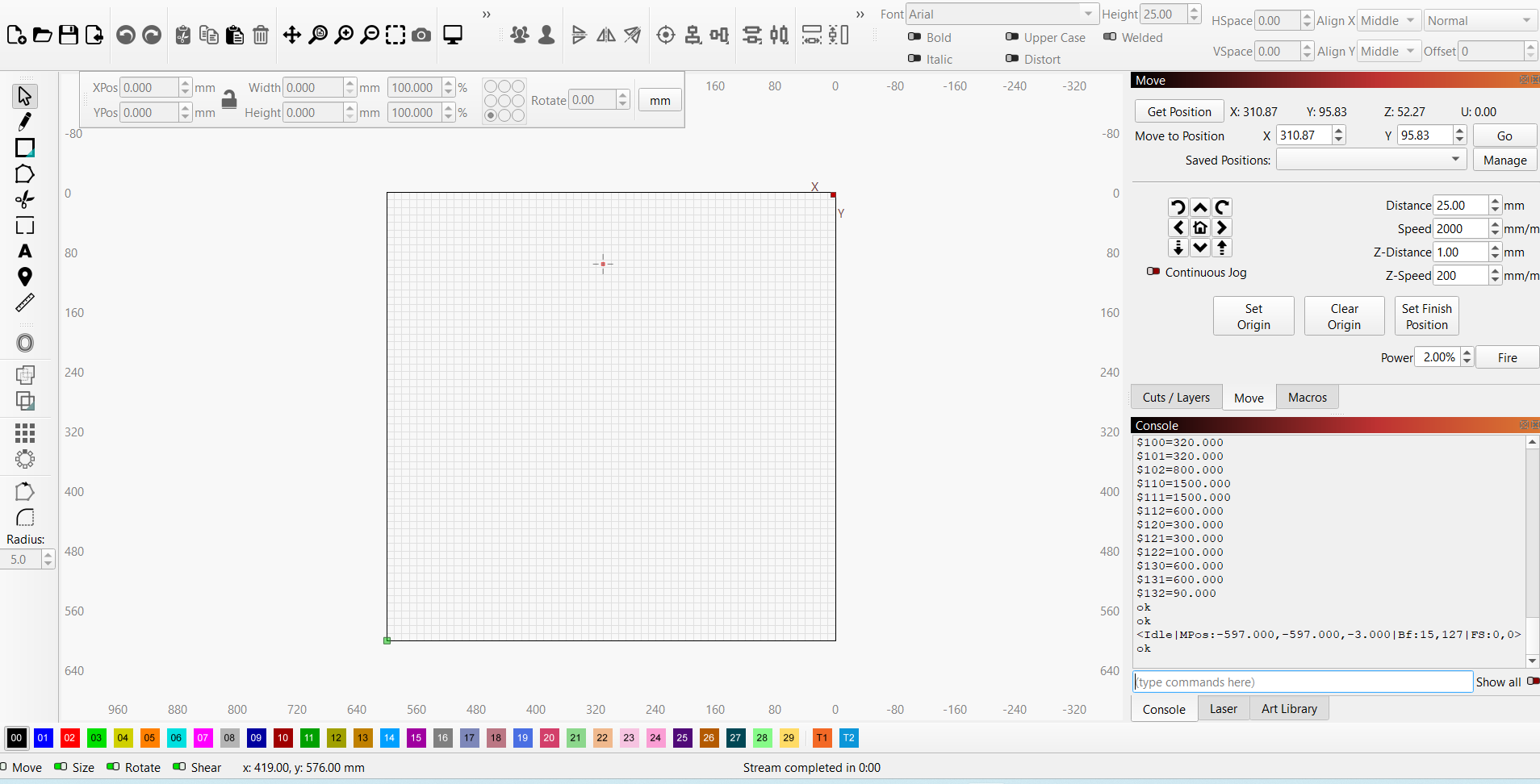

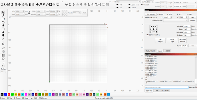

Attached are screen grabs of the settings in lightburn, along with the main screen of lightburn. After homing, which the machine does to the bottom left with z at top, it shows, according to the main lightburn screen, that the laser is very near the top, a little to the right of center.
Moving left, right, up, down, z-up, z-down, all work as expected – EXCEPT – it thinks its at the top of the work area so it won’t go beyond that – when in reality it’s only about 4-5 inches from the bottom.

I’d advise you to turn off $J continuous jogging at least for now.
When exactly did you get the out of bounds warning?
This can have multiple reasons. For example: If your designs are placed very close to the edge of the workarea and you’ve set an Excessive Overscan.
Does it also happen when you use Absolute Coordinates as the Start From value?

It gives the out of bounds as soon as I click start. even if it’s a new project with only a 1” square in the center of the workbed.
I have not tried absolute coordinates.
