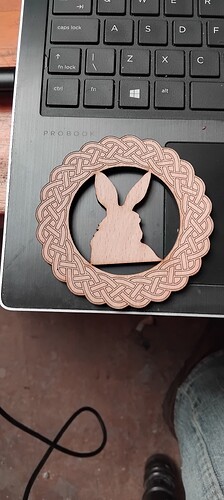

Hi all
I got some great advice from Wren about using the rubber band selection used internal to a circle, but before I can do that I have to sort this issue with an outline of a rabbit.
The rabbit is required to be welded inside a circle and the sections either side and between the ears gets cut away and rabbit face details can then be engraved.
I have tried many times and read the Doc’s on weld/boolean/assistant but I either get the rabbit vanishing or the rabbit & circle seem to group but not weld.

In this instance a Boolean Subtract is the correct choice. Selection order matters. Select circle, then shift select the rabbit. Click Boolean Subtract or open the Boolean Assistant so you can preview what will happen before committing.

If you want, you can upload the lbrn2 file including the cetic knot,
then we can have a lock at it or even clean it for you or make proposals, how to do it yourself.
Here is a first attempt, maybe it will be of some use
039_celtic_knot_rabbit.lbrn2 (221,9 KB)
Tilman

Thats amazing,
I increased the speed and dropped the power 1250/17.5% and reduced size to 90mm, just to see the outcome a bit quicker.

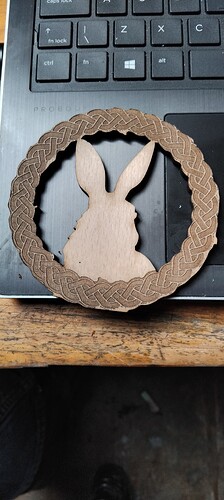

As allways there are a lot of different solutions for a problem: i would use „edit nodes“ to change the file up to your wishes …
Couldn’t get the rabbit to work, while all shapes etc work fine so I swapped it out for a harp and tried a different Knot design as its a bit quicker.

The Harp and knot came together petty well and thanks for your help (Thanks also to Tilman & Wren) with the boolean-subtract as I may have never considered it an option…brain stuck on weld!

@Pete.IRL: in this video you can see, how i did the rabbit surrounded by a celtic knot.
how to do a rabbit with celtic knot
steps
  1. Import an image “Celtic Knot Ring”
  2. Trace image (Alt-T)
  3. Assign layer → Fill
  4. Offset shapes (Alt-O)
  5. Assign layer → Line
I moved the “Celtic Knot Ring” to the side for a while so you can see what’s happening.
  1. Draw a circle
  2. Center both elements of the blue layer
  3. Select the outer shape and then the inner one
  4. Perform Boolean operations A-B
  5. Import an image of the rabbit
  6. Trace image (Alt-T)
  7. Assign layer → Line
As already described in several posts, Lightburn currently cannot “trace center line” (yet).
Therefore, you must now remove one of the two lines. To do this, ungroup them first.
  1. Fit the bunny into the ring so that all four corners of the bunny overlap the ring.
  2. Select the bunny and the ring.
  3. Use the Boolean operation “A or B.”
  4. Center and group all elements, and adjust the size if necessary.
As always, adjust the layer values ​​(speed and power) to suit your laser and material.
