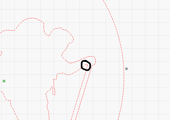

cannot get the letters and heart to weld. weld and booleen is grayed out.
The outline of the hikers and circle intersecting the letters is not closed. It’s difficult to figure out where the break is.

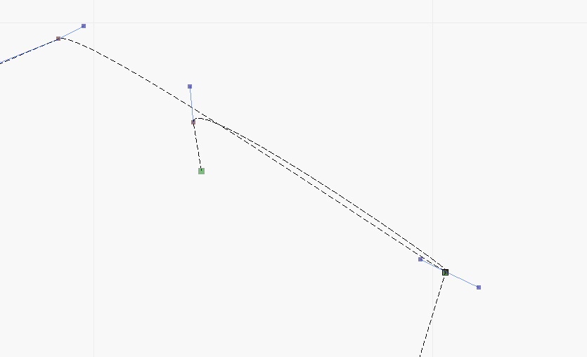

There is the file with that shape closed.
parker.lbrn2 (136.4 KB)
better fix without the squiggly line
parker.lbrn2 (136.3 KB)
Thank you so much! I saw the open shape but couldn’t find where it was open
