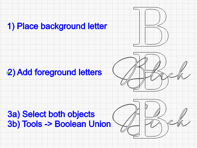

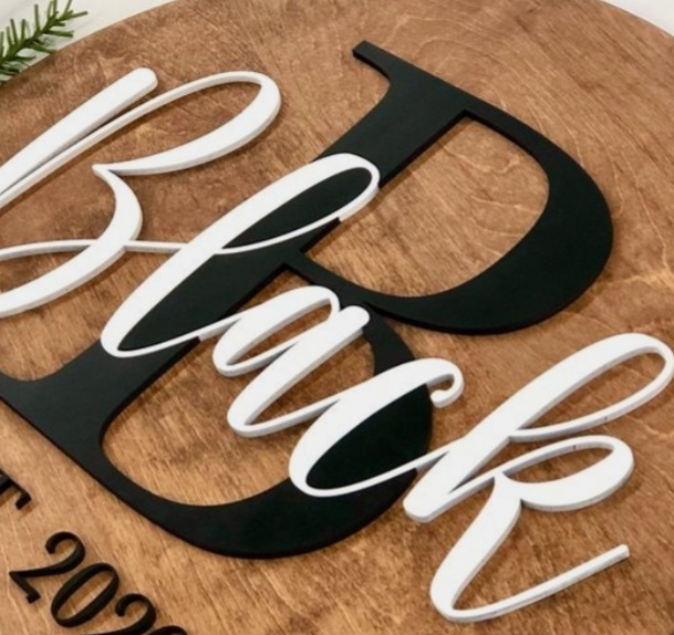

Does anyone know how to slice or weld a name through a letter like the photo? I would like the name to pass through the letter so they are the same height. I have tried all of the welding tools and they are not doing what the videos show they should do.
I’ve illustrated the steps here to do something like this.
YEEES!! This is exactly it!! Thank you
