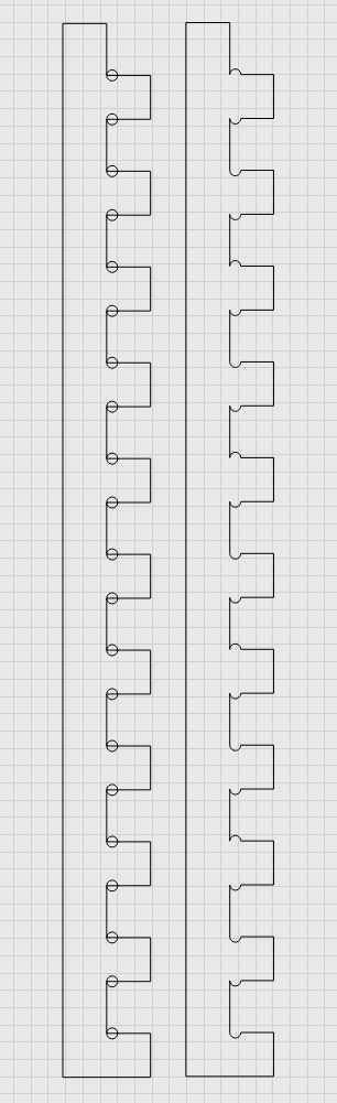

When trying to weld there is no options for specifically what type of weld id needed and gives a very unwanted array of results. In my particular design i am trying to create a box joint with reliefs for the tool. when useing array to place the circle relief in the corners and then welding the program seems to do what it wants with each weld. This happens when selecting all or doing individual as well as useing array or placing each manually.

Which weld is desired, the innie or the outie in the notch?
joint.mage (23.0 KB)
innie as you put it is the desired result
I messed with it and could not determine for sure, but it may have to do with the uneven tooth sizes and spacing. I used one circle at the bottom and the Array Tool to spread out the rest of the circles evenly. I am guessing the parsing engine is seeing different conditions at each intersection.

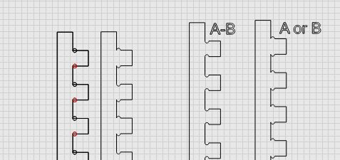

Have you tried the Boolean Assistant?
Boolean Assistant style

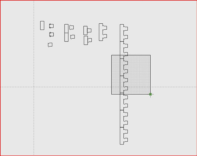

Every other circle was grouped. If you group all the circles and use the Boolean tool, you can get this output.

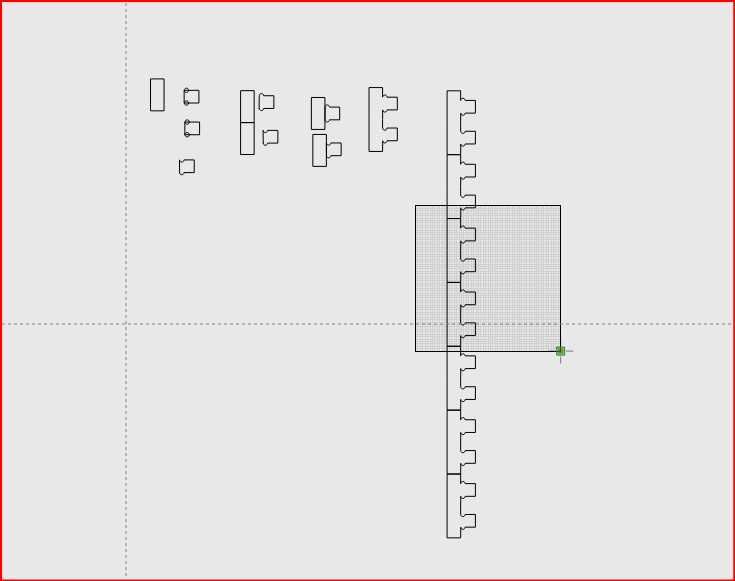

another way instead of drawing multiple circles and getting them to line up
dthois is how i would do it starting left o right in sscreen shot
