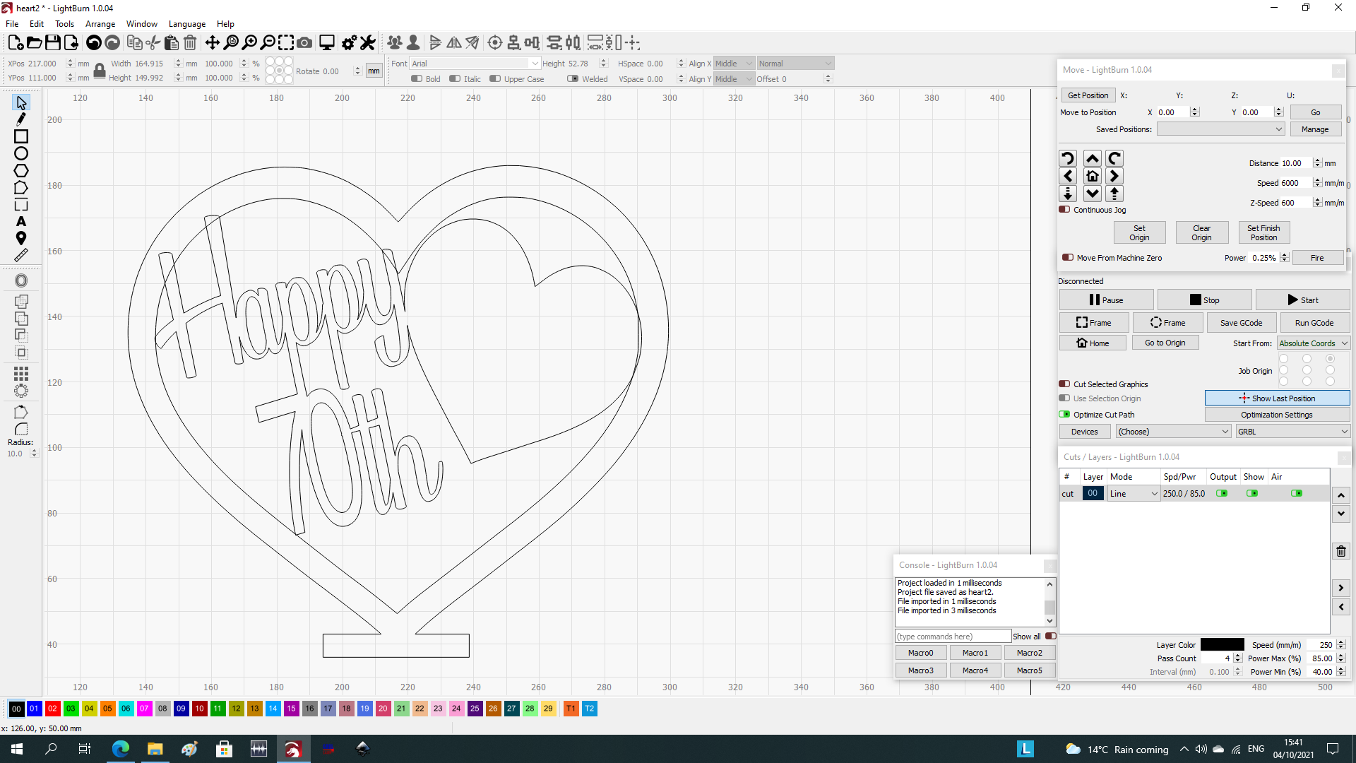

hi all I have imported a shape traced it and now I want to add text to it but every time I got to weld the text it just vanishes it just not happening I have been at it 7 hours and got no where any help would be greatly appreciated

thankyou for them that I absolutely what I have do but it just wont weld
I have put two screen shots up above

happy 70th heart.lbrn (140.4 KB)
happy 70th heart Fixed.lbrn (116.4 KB)
I selected the inner heart then the words. Pressed CTRL-B and used the Difference B-A

The issue is the inner/outer heart shape is not a single or continuous piece.
If you select both outer and inner heart shapes, weld them, select the text w/control key pressed (so you don’t lose the previous slection) and weld that…
That’s how I did it. Selected inner heart then text. I’ll edit my above. The weld function didn’t work but the boolean did.
I’ll retry it and see if I can get it to work. I selected both heart shapes… Lightburn is pretty smart…
thank you all that works great now don’t know why the weld doesn’t work
you have all been a great help
CTRL-B brings up the boolean wizard. Not sure what button it is with a MAC.
Weld is doing exactly what you’re asking it to - it keeps the overlapping area of all the shapes you give it.
Use either Boolean Difference to subtract the text from the inner heart, OR group both hearts into a single shape, then Boolean Union the text with the grouper hearts.
