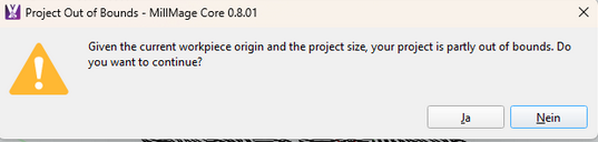

My process is as follows:
1: I start a new project and enter the workpiece dimensions.
2: I draw my project and add a new operation.
3: Then I go to the process settings and select my milling cutter.
4: In the grid method, I move the arrows so that the milling head is approximately 1-2 mm above my workpiece.
5: Then I use the arrow keys to move my workpiece all the way to the back.
6: Now I switch to the “Go To” position in the grid and press the XYZ0 key.
7: I started working on it. Then I got the message: “Due to the current workpiece origin and project size, your project is partially outside the permissible range. Do you want to continue?”
After that, I canceled the process because it wasn’t working.
My projects are always smaller than the workpiece and the mass of the machines.
This is my workflow, in order of how I work and how I proceed.
In your MillMage preview the shape is all there.

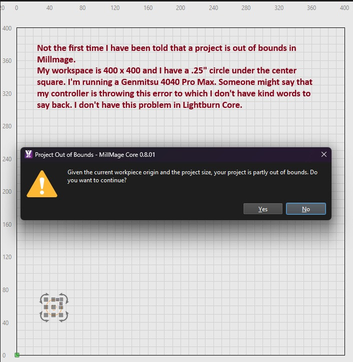

Have you clicked Yes and let it run the job doing an air cut? I have the same error message, but if I click Yes it runs the job correctly. I posted about this earlier, but never got any answer as to why it happens.
This is the thread I posted in:
Hopefully someone on the dev team will take a look at it.
@soniclab
In your Project Setup Edit, you have 20mm Safe Clearance Height, but no clamps on your setup. Maybe try changing that to about 5mm and see if you get the error message.
I agree with @misken that it is a coordinate issue. Did you try changing that 300 to 280 to see if it would run? It might be computing something like a boundry error because it is at a machine limit.

Yes, the form is there in the preview, but when I try to start the machine, I get the message where I’ve uploaded a photo.
So it was actually going thru the motions, then suddenly popped up the alarm message?
Put the tool in. You should not have changed any settings for the test.
I tried it with the tool, but it’s running in the air. Unfortunately, I can’t upload a video here. How can I stop the machine from milling in the air?
How did you get it running in the air? Have you ever cut anything with it?
When I confirm the error message that always appears (see screenshot) by clicking “YES,” the machine mills in mid-air. And I haven’t changed any settings. Apparently, I’m not the only one with this problem. Unfortunately, no one seems to have a solution. Neither Lightburn support, Millmage support, nor anyone else I’ve asked has one. I just want to be able to mill. It’s not the machine, as this problem also occurs with other people who own different machines. Surely there must be a solution to this problem?

UPDATE: I tried a couple of your files and got the OOB message on all of them. I then loaded one of my files I ran a long time ago and I also get that Out Of Bounds message. So it looks like we have a task for the developers.
I am including @Rick so he can get this detail to the right people.
6m Jpole Spacers.mage (44.8 KB)
In the meantime, your “cutting air” issue may be due to not setting Zzero tool tip at the top of the material. As for the OOB message, click Yes and go on. Once I did that, my old file ran as normal.
