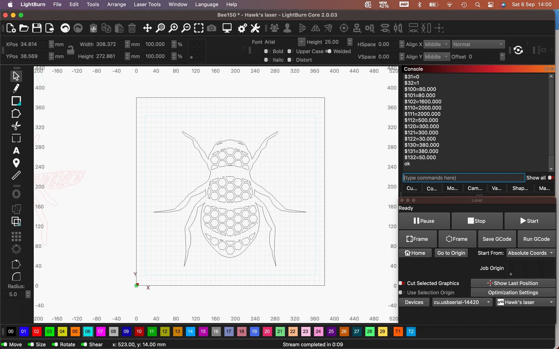

Trying to run a program on my Masuter Pro 40x40 and every time I hit start, the laser either goes off to the top right or over to the right and slightly up a bit. It homes in the right place but wants to start elsewhere. Once it gets over to the right, it cuts out as it has hit its limit switch. I’ve tried all 3 start positions, i.e. user coords, absolute and current position, but always the same thing. In move command, the arrows move the laser in the expected direction too. I’ve even tried loading a different job in to it, but still doing the same thing.

Ah! I think I’ve sussed it. The CNC button was not checked in the settings menu. All working perfectly now. :slight_smile:
