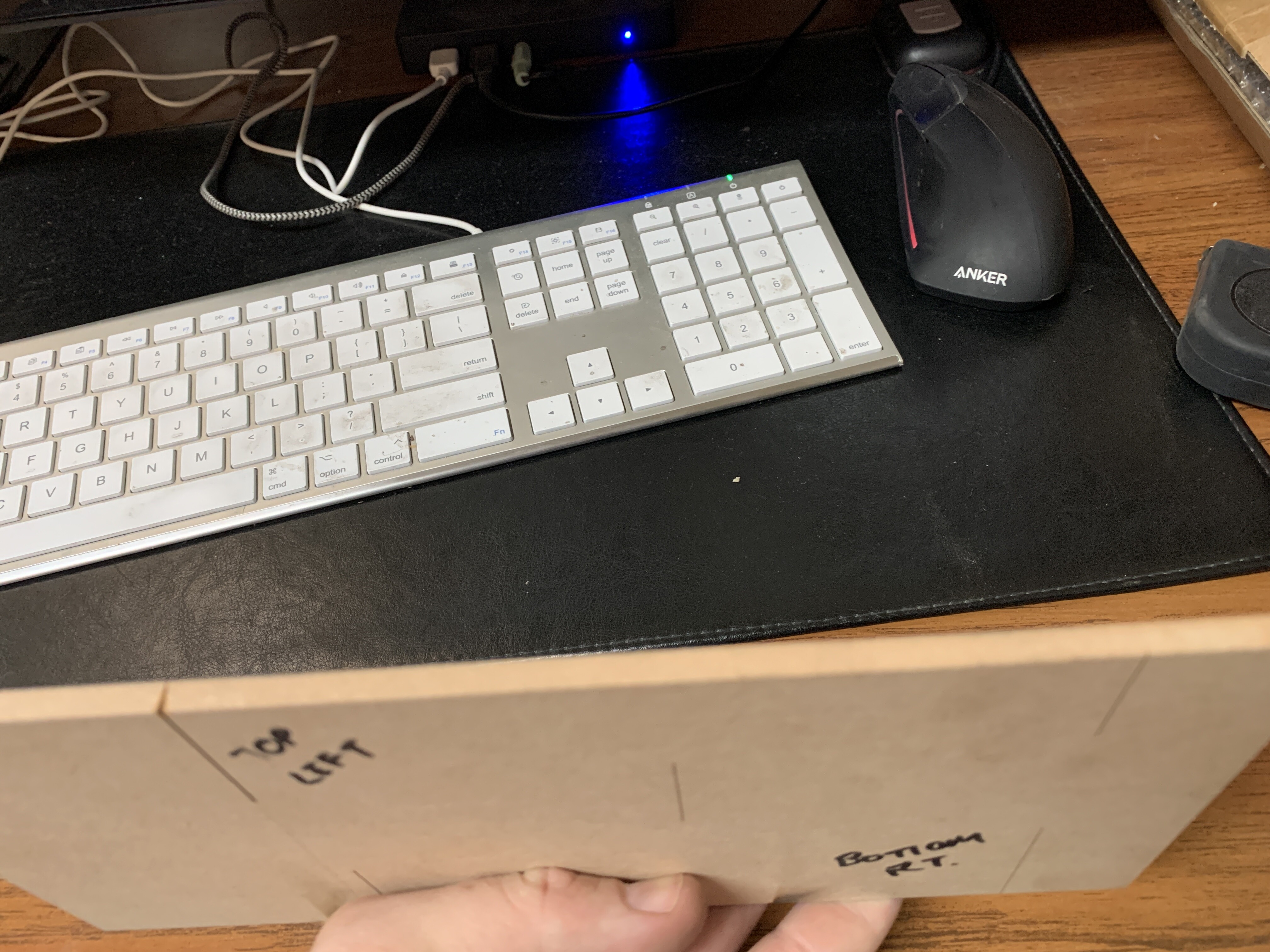

What I’m trying to achieve is a consistent cut and what I’m experiencing is almost too much power on the bed corner closest to the emitter. Is there a working distance spec from the end of the tube where cutting is optimal? If you look at the attached photo you’ll see what I mean. I’ve spent hours checking alignment and checking again. My bed is dead flat. This is the same focal distance same laser power but the kerf and penetration of cut is SUBSTANTIALLY greater. Notice how I get a nice clean hairline on bottom right. Furthest from the bed, razor sharp focus. As I move closer to the emitter (top left) my kerf is about 5x in thickness. (0.5mm vs 0.1mm) No matter what I do up in that corner I can’t seem to effect the cut thickness. I’ve tried refocusing in just that corner and I cant get the beam to focus nearly as cleanly. Again after the beam has travelled about 70cm or so it seems to “tighten up” I just can’t figure out what I’m missing. I know power will always be more intense the closer you are to the emitter but I should still be able to focus it no? The reason I’m exploring the beam pattern stuff is it almost feels like the tube is emitting a thicker beam right at the emitter? I can’t think of what else would contribute to a thicker kerf like that.
It is not so long ago that there was a post here with the same problem, it still ended up being a setting problem of the mirrors, the lens and the bed. (I read that you did it all)
Maybe I’m missing something on my alignment. but it all looks correct. I ordered the reverse laser tool from American Photonics to see if that reveals anything I missed.
just a little curiosity, it took me weeks to find out that my cable duct was just a little bit too tight and could lift the entire nozzle head rear 0.2mm, at the end furthest away from the mount.
Have you done Russ Sadler’s “anal thermometer” test at all four corners plus the center of the bed to see if your beam stays centered/vertically aligned straight up and down from the top of the laser head down through the nozzle? If your beam is coming out at more of an angle in the upper corner, it could be the source of your problem. This test revealed an alignment issue I have been chasing for quite a while. Here is a test example created a while back. You can see the issue. I have been able to correct things some, but even now, it still isn’t perfect.

Neat little tool but looks pretty spot on to me. Checked square with the bed in all directions too. I’m really at a loss here, it really feels like the beam just doesn’t focus as well up at that top point for some reason I still can’t pin down.
