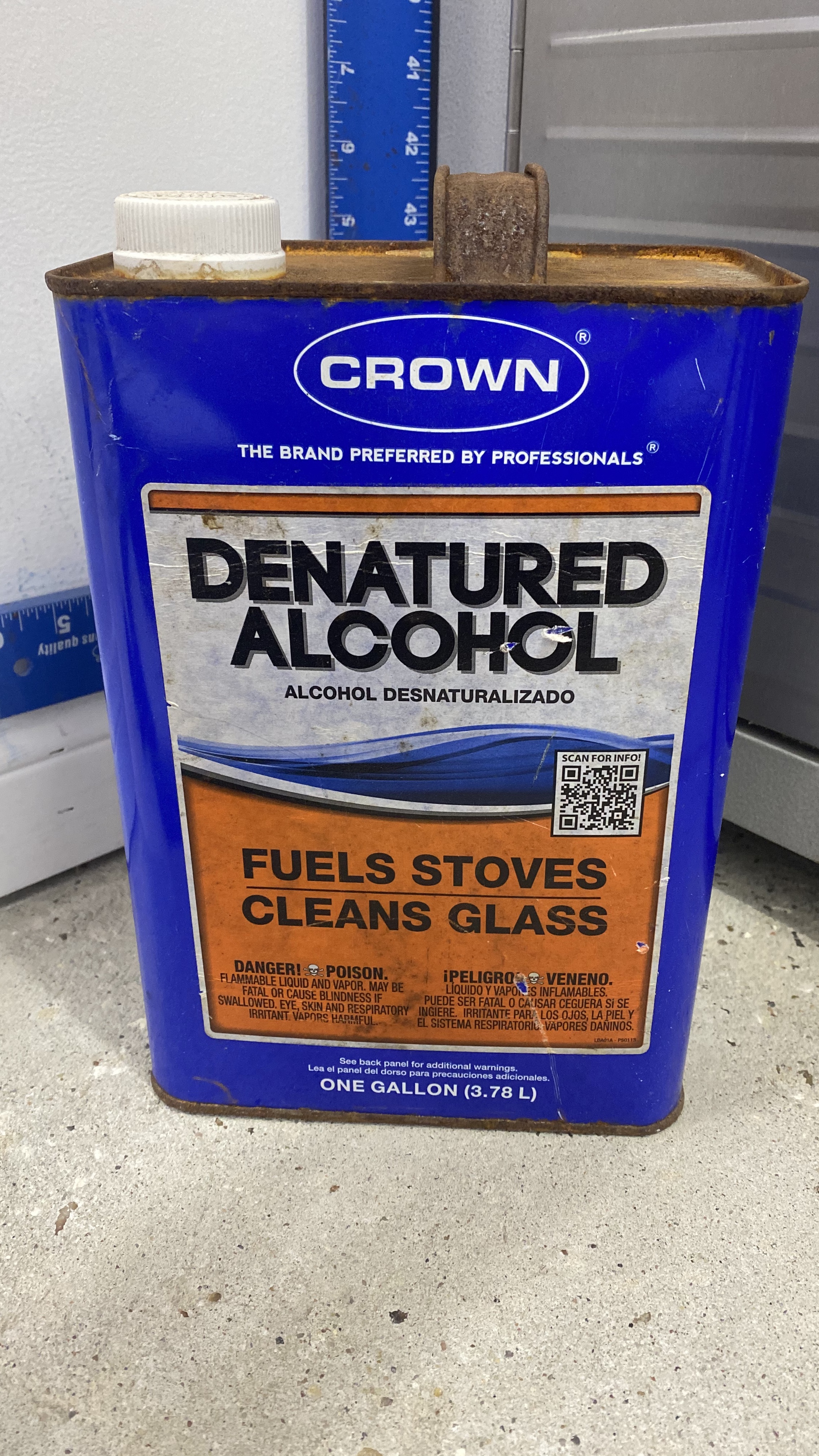

Methylated spirits. Denatured alcohol.

Denatured alcohol is great for 99% of the time you need to clean.
