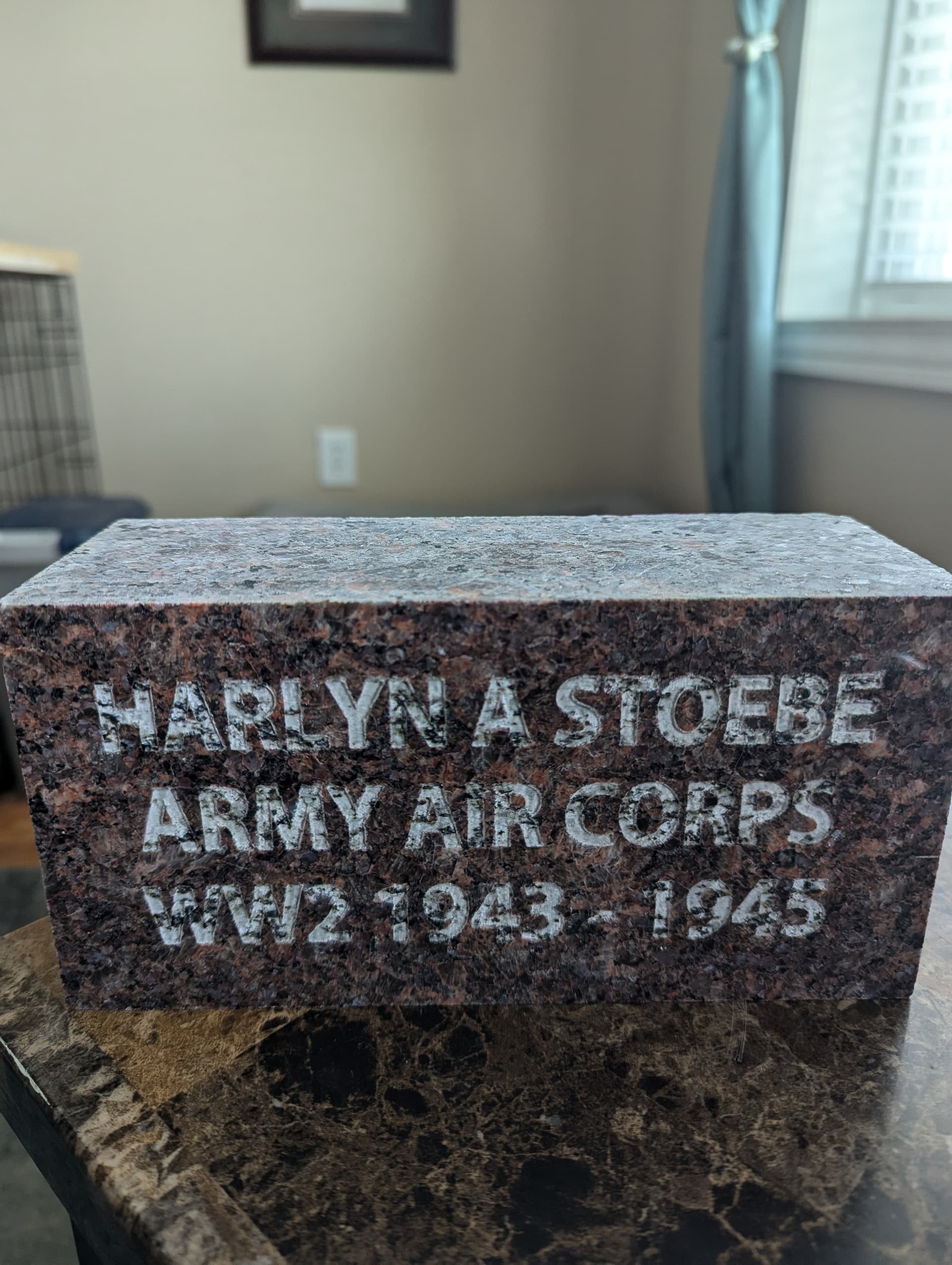

Hello. I have an Omtech 80W laser using light burn 1.7 with a Ruida controller. I have been asked about engraving bricks for a Veteran’s memorial. They already have the bricks so purchasing bricks specifically designed for laser engraving is not an option. The bricks are actually granite. I did a couple of samples for them and they love the look but they want the engraving to be deeper. The lenses and mirrors I have are the ones that came in the laser when I bought it, but I have read and watched several videos that mention using bigger lenses and mirrors. Is that accurate? If so, what size/type should I use and how much would you charge per brick? Each brick has 3 lines of text up to 20 characters per line. Thanks in advance for the help!

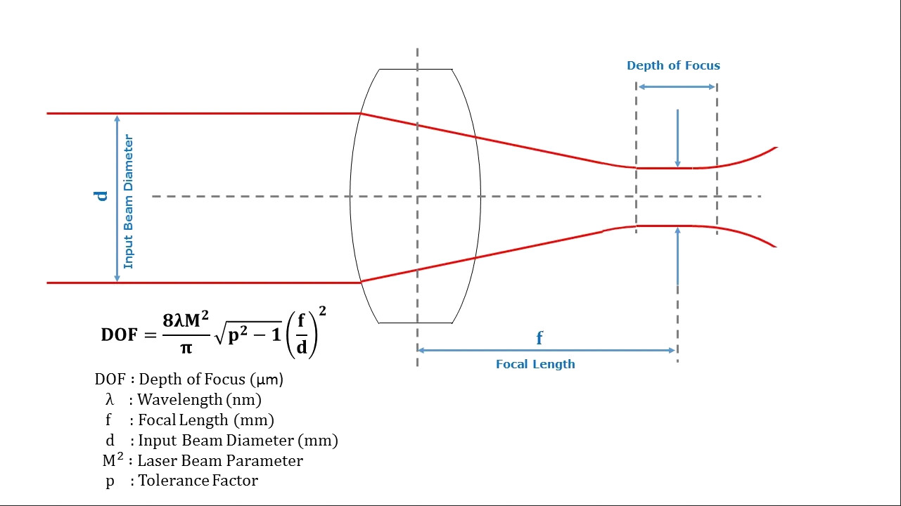

Approximate spot size and dof for different lenses. Based on a 6mm input beam size.
Length spot size microns dof mm
38.1 - 1.5" 154 1.54
50.8 - 2.0" 205 2.75
101.6 - 4.0" 410 10.92
177.8 - 7.0" 718 33.5
If you use a longer lens, you could go deeper and remain in focus. You will need some type of air assist to blow out the debris. Best application is to focus in the middle of the material.
Good luck… pretty tough stuff… can you show us a photo?

I will post a picture soon. I currently have a 2" focal length lens that is 0.71in in diameter. I am a newbie and not 100% sure how I can accurately measure the depth on this, but I believe I went about 0.8mm and I am guessing I will need to go about 1.6 - 2.4mm deep to meet their desired look. As for the mirrors, does a higher quality mirror provide a deeper/cleaner cut/engrave? Or is that mainly based on the lens focal length?

I think you can do it, just add some more power and focus down about 2.5mm into the surface…
Might want to do one, and see where all that rock goes… might have to do maintenance of the basic machine surfaces more often.
I’ve done this on my 40W, really not excellent results…
