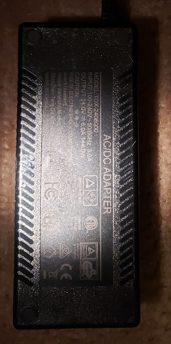

I checked the power adapter. It was actually pulled loose from the plug. I reconnected it and unplugged the USB. Then, I unplugged the power and plugged it back in without the usb. The light isn’t blue. It is red and green beeping 1long and 3 short beeps. I don’t know how to check the statement below.
This - . . . beep indicates the machine is not getting 24v
Turn the power adapter over, read its label. Does it say
OUTPUT 24v 6amps?
Regarding the 5v
When you have your usb cable connected to the computer and the motherboard, the computer sends 5V through the usb cable. This voltage is enough to power up the motherboard - ence why it can connect to the computer - but not enough to move the motors.
Unplugging USB makes sure you are testing the 24v power rails
Yes, it says 24v
if your power adapter is infact 24v 4amp or higher
And machine beeps instead of homing
And key is ON and Emergency switch is up
Then i suggest you
  • try a different power adapter of same rating
  • contact customer support, i think your power adapter failed
