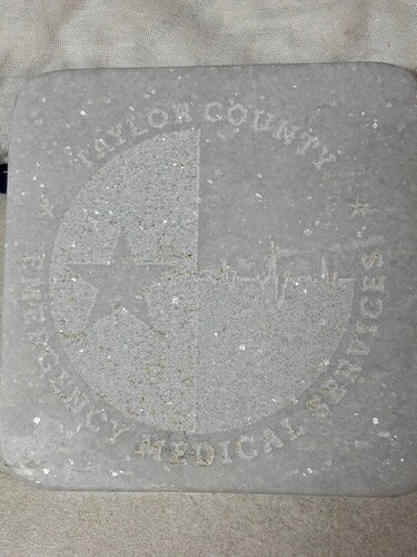

What engraving setting do I need to use for soapstone?
I have been trying to locate a good list of settings for different materials. I found some but they do not show a setting for soapstone. What is a good setting to use to engrave letters as well as image on soapstone?

the soapstone is coaster size. About 3.75 inches square. The image is just under that size so to have somewhat of a margin on the sides of the letters and graphic.
The color is an off white

NONE for a diode laser.
On my 10w machine, I set 254LPI and 90% power. Air assist made no difference. I kept reducing speed in 500mm/m increments, from 2500mm/m to 500mm/m. All it did was warm up the soapstone a little.
So I drop it in the 40w laser at 90% power and 1000mm/m to see if a visible light diode laser can do anything at all. If I tilted the soapstone in the light, I could see some marking, but it was not consistent. Oddly enough, the soapstone got barely warmer than with the 10w diode. This indicates the translucent rock was barely absorbing any power at all.

I think your problem is the color. White reflects all colors, so no matter what color you laser is, it won’t likely engrave much into your soapstone.

I figured it out. My laser set at 30watt the settings in Lightburn is 90%power and 30inches per minute speed.

Here is how it turned out.
Now to figure out how to add color to the specific areas.
Acrylic Ink (dabbed on so you don’t brush ink under the edges) and Masking tape. If I’m using Ordinary masking tape I use 45% power (20w diode) for a nice clean cut.

Meant to add, low power (5 - 7% at aprox 3000mm/m) and a wide Line interval will shade the lasered ink…and not obliterate it…Cross hatch if you have the time.

As far as lasering is concerned, soapstone is just a general name for a wide variety of possible compositions of minerals:
I haven’t tried it yet, but from what I do know about the use of soapstone and its varying properties, it wouldn’t be my choice for a visible spectrum diode lasering.

For at least the varities over here -and we do have soapstone in abundance here- “wetting” the surface will produce quite dramatic change in appearance.
Ours often has a green tint, with all sorts of streaks.
Even water will stay deep in the pores for quite a while, but will obviously evaporate in time, other less evaporative liquids will stain the stone “forever”.
Since at least that example of Yours looks like a coaster and spills from beverages will stain it anyway, I’d second @Pete.IRL 's suggestion of increasing the contrast by staining.
You have to find out the exact liquid to stain that partiqular variety for the desired contrast Yourself, and unless You can be assured somehow that all the material comes from the same quarry, be prepared to adjust the process if a good consistency is the requirement.
