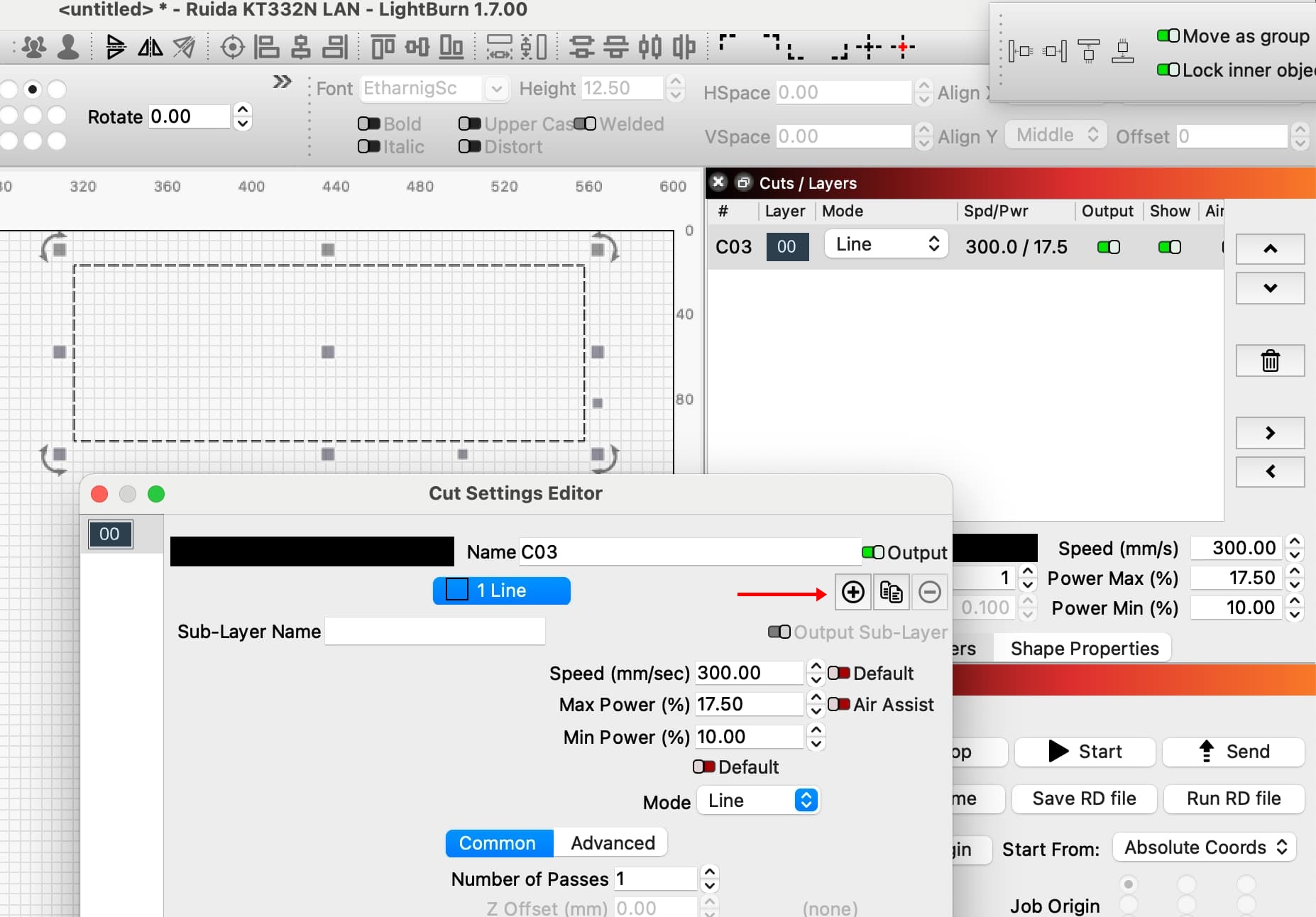

I downloaded 1.6 and can not seem to understand why the screen to make sublayers is gone. I would attach a screen capture showing my new screen but I do not see that option here.
Nothing happened to Sub Layers as far as I’m aware. They’ve never been available for images, so if what you’re using is an image that would explain it. To add an image to a post you can either copy/paste, or click the Upload icon here, when posting:

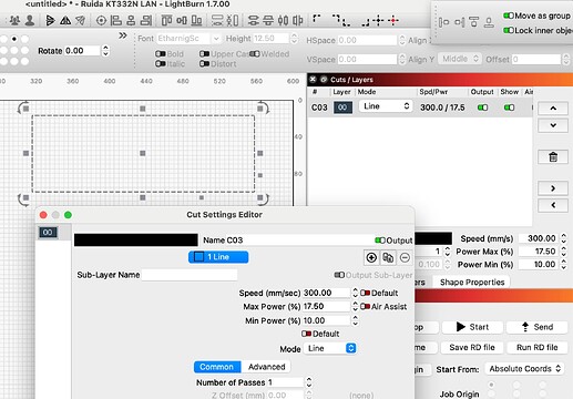

Possibly you haven’t double -clicking your layer …?
In the layer properties, the submenu for multi layers emerges.
Using @bernd.dk picture, and after you press the “plus” key?
