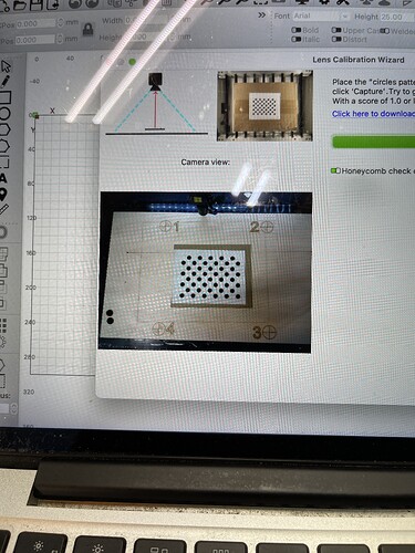

Here’s what I noticed today , no matter what the camera is viewing it at a slight angel . Im trying to calibrate it again and I noticed this
First photo is of my bed to show everything is straight
When looking at the laptop, it looks slanted
I am using a 60 degree camera , been using it since day 1 and it use to work perfect !!
Getting real annoyed
Below is what I am trying to correct
Trying to correct the view so when I update my overlay the whole bed is updated properly
