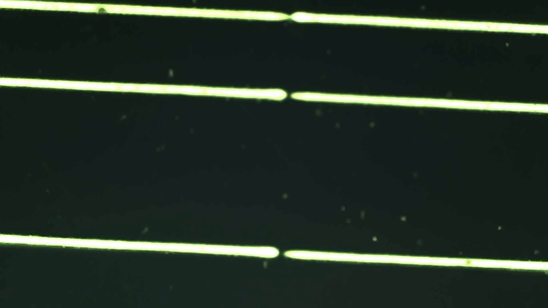

Never messed with it but I will. Issue I get with start and stop TC, it moves the end of the line but (in my case anyway) I get a skinny start and a matchstick stop. I can move the end but it still is skinny/ matchstick, just further right or left. Makes sliced fills visible on X table .
Top line is right to left, bottom 2 left to right. Forced a start/ stop gap with a slice. 2000 X magnification.
