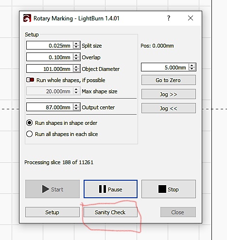

What is Sanity Check
What does sanity check do?
Not following, please share a screen capture of what you are observing. :slight_smile:
2023-08-24 (2)
Okay, now I’m curious.
Welcome and thank you for posting this question. As the name implies, it is designed to check the job parameters prior to running the job and report back if there are issues. Checks for things like engraving vertically while rotating the rotary vertically with a really small split size, or using “run whole shapes” but having “fill all shapes at once” set. :slight_smile:
