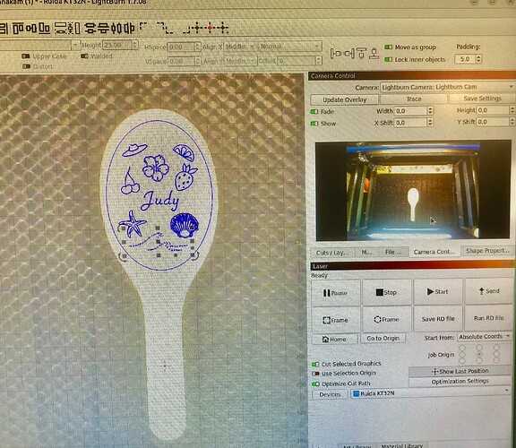

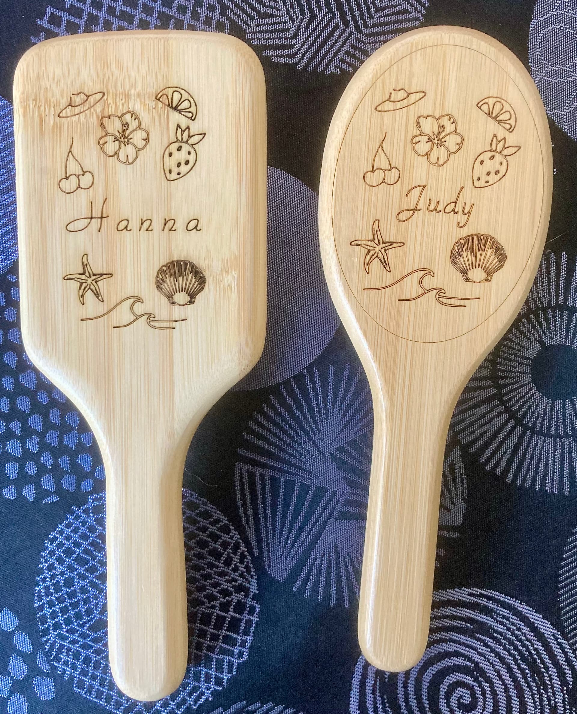

We did a little project together, she drew it and I burned it.
The girl bought the hairbrushes herself which were to be turned into a personal gift for her friends.
Instead of making a jig or spending tons of time adjusting, framing, adjusting…, I use LightBurn’s camera system for this type of task. It is very uncomplicated, precise and quickly done, I love this option in LightBurn.

It’s easy to spot the Perfect Master of the craft … :grin:
Great example of how a properly calibrated camera can be useful.

This is the first time where I could see having a camera is actually useful. I did not know you could impose your drawing on the camera image. Thanks @bernd.dk , now I have to spend more money! :joy:

@mikey, this is just for fun, the real value I get from using the camera system is in the daily work of using it, especially in material management and transferring text or graphics onto very irregular shapes. You won’t regret opening the door to the possibilities that a well-tuned camera system offers.
