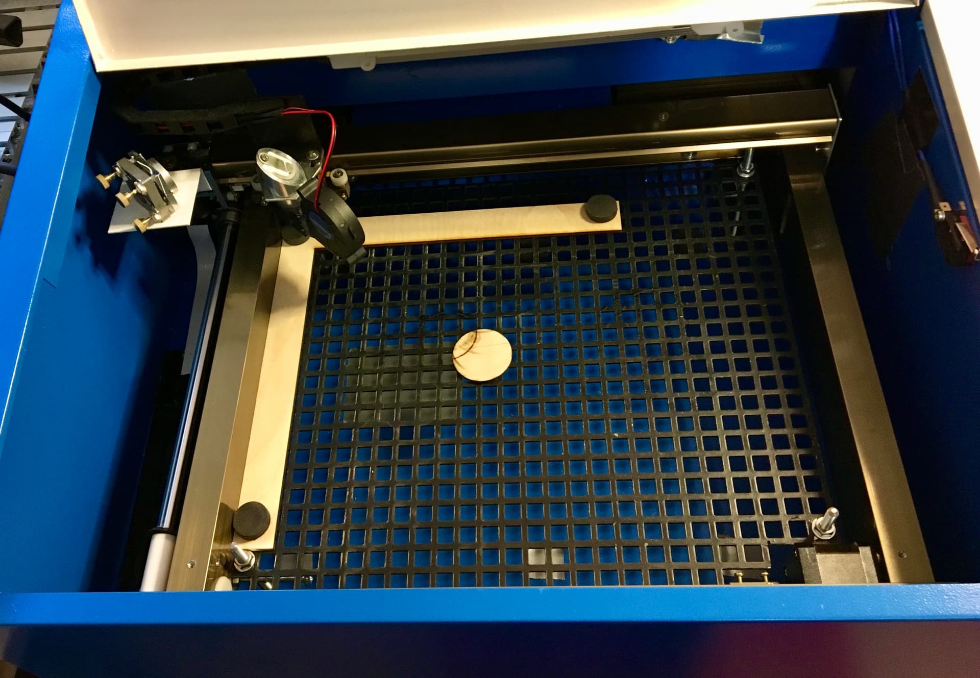

Different perforated sheets are available, if there are knives already, I would choose the one from picture no. 1. It has many holes but is still very stable and nicely flat.

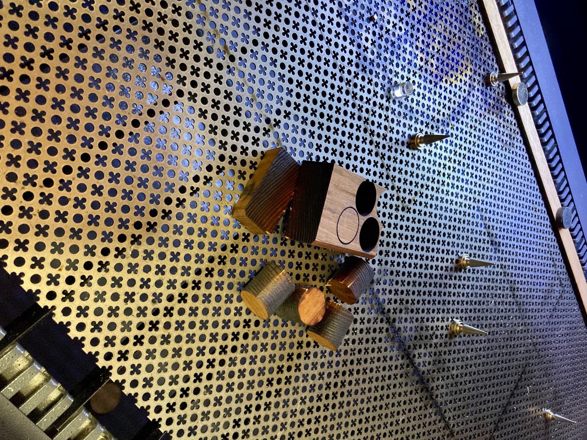

On my K40 I used the type from picture no. 2, it also worked fine.
I would go for 1.5-2mm+ thickness, even though or because it is relatively heavy, I have not had problems with flatness. Furthermore, there are very nice options for clamping the sheet firmly and fine-tuning the height in the different regions so that it is flat all over.
The sheets are available (here) in 2000x1000mm and can be adjusted with an angle grinder or enlarged by welding.
Avoid galvanized steel sheets, black steel is fine for the task.

With a thick sheet You may get away with a simple cross grid, a thinner one may require a 3x3 grid (Tic-Tac-Toe grid).
I would include a some sort of fine tuning capability to the grid design, helps getting and keeping the bed as flat as possible.
If You can find such a sheet easily, I do second the “middle eastern” pattern design @bernd.dk suggested.
