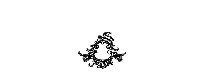

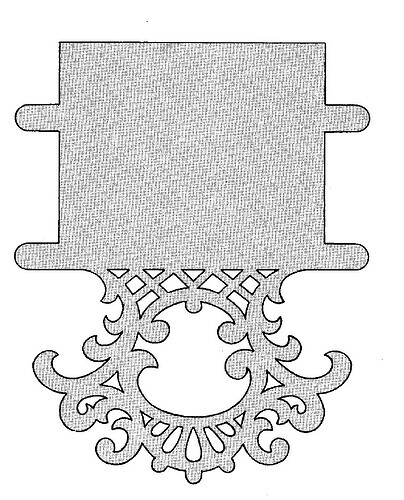

I have a book of Scrollsaw Patterns and this is a sewing basket part of it, I scanned the image but the shading comes out worse than what the plan shows and when I use the TV in LRB rather than nice clean lines I get this.
This is a pattern from my Scrollsaw Book and I was hoping to get clean sharp lines, instead I get this overload of dots which makes my lines come out terrible.
After scanning and uploading into LRBN I went to Tools> Trace Image then used the traced image for my laser patern and again the shading really messes up the clean lines. I wanted nice crisp black lines on a neutral background

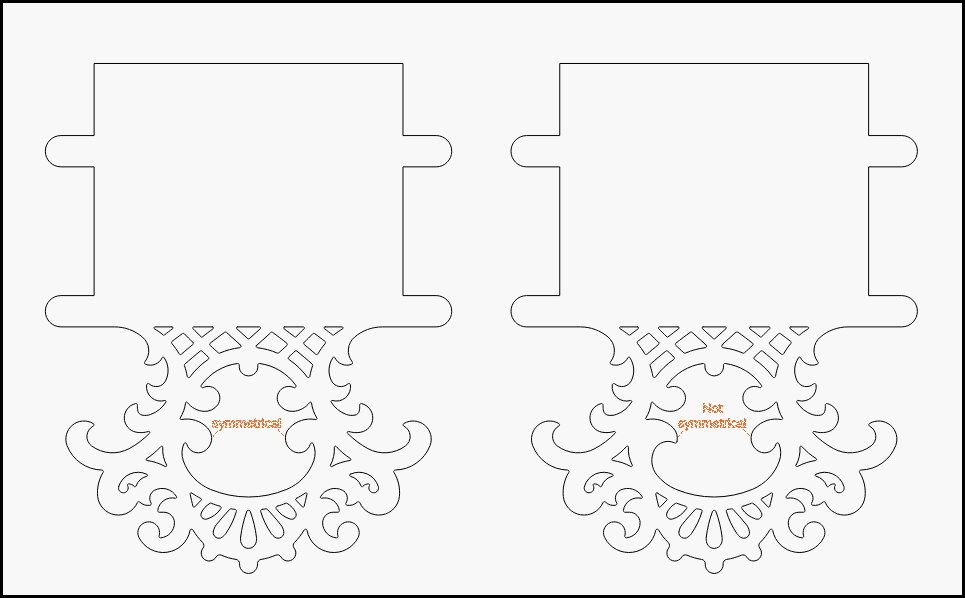

There are 2 versions. One has the inside shape symmetrical - the other isn’t symmetrical per your provided shape. This isn’t the exact size as yours. I rotated your shape about .25 degrees to build 1/2 and mirror it.
Basket.lbrn (225.2 KB)

The fretwork (?) pattern inside the basket is more of a grayscale blur than a black-and-white grid, so there’s no setting of the Threshold slider that will produce a clean result.
You may be able to engrave the pattern as an image, rather than trace it into vectors, to get a reasonable result. That will surely require some fiddling with the image to crisp it up, then more fiddling with the engraving parameters.
If you really want crisp lines in there, you must replace the interior with a vector pattern you created. I’d start with a single “cell” of the pattern you want and replicate it into a huge block with the rectangular array tool:

If you dink around with the Threshold slider, you can keep the dark outline and eliminate the grays, but that’s about the only control you have over them.
If you’re scanning the patterns from the book, using a much higher resolution may get more detail into the image and give the tracing algorithm more to work with.
