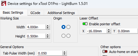

Most likely you have machine Origin set incorrectly. Go to Edit->Device Settings and make sure your origin is set to top-left. If not, change it.
Thanks, but it is top left.

EDit - device settings
What you ahve set as origin?
It should be ok, although admittedly I am not expert on Xtool

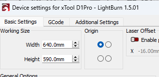

What you have incorrect for sure is the width and height of the machine.
I will let someone that actually KNOWS Xtool give their feedback
Do fix your working size it does matter

I am inclined to say try Origin Front Left, It “should” fix the problem but i wouldnt know explain why. so i rather allow someone that knows explain
It definitely should be top-left for D1 or D1 Pro.

Also, is there a reason why your working size in Device Settings is so small?
I am new to this and trying to print something on a small block. Anyhow, thank you device settings updated.

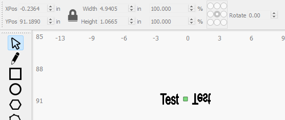

There is a test I put together.
Result (I did not align wood very well in laser (in a rush).

I think what’s happening is that your work area is too small and you are working in negative coordinates.
First, push the “In” field in the Numeric Edits toolbar on LightBurn. Once pressed it should switch to “mm”.
Then go to Edit->Device Settings. Change working size to width of 400 and height to 430 mm. Then Ok.
You can switch mm back to in if you like.
Place the design in the middle of the workspace. Then retest the burn.

But I already made device settings larger.
in mm
Provide a full (not cropped) screenshot of LightBurn please with the design in view.
Where are you getting the values for working size?
working size from xtool… I went back and tried same thing from xtool software and do not get the same issue.
